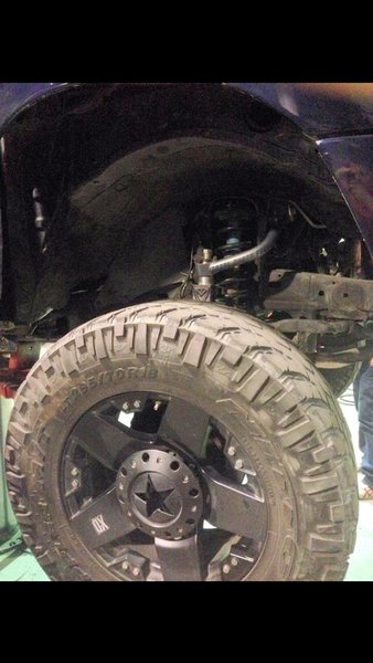

    http://www.tacomaworld.com/forum/2nd-gen-builds/227832-my-never-end-build.html
    Installed mine yesturday
