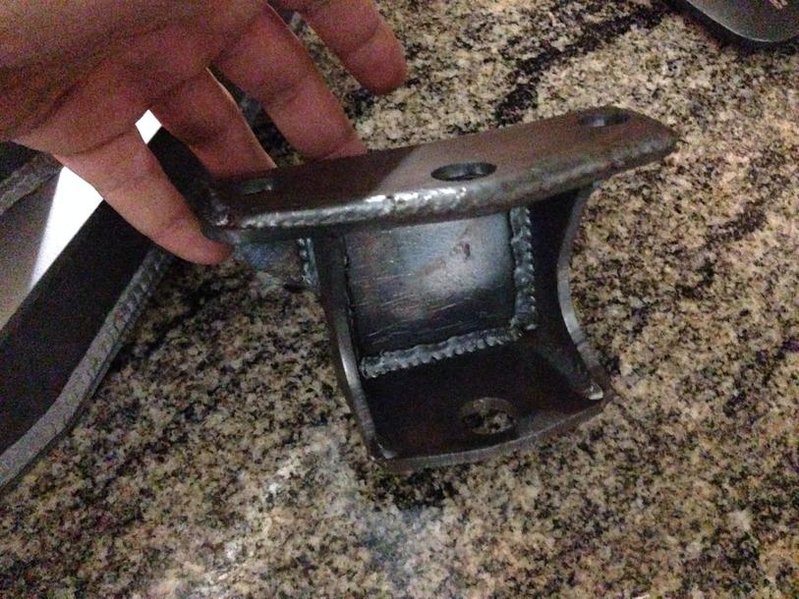

    JUST BOUGHT A ENGAGE +4'' LONG TRAVEL AND HAVE MAXTRAC SPINDLES, DO THEY FIT WITH ENGAGE?

    Go to this post below and see if your spindle adapter looks like the picture. If it does you will have to make some spacers like he has in the picture.
    http://www.tacomaworld.com/forum/su...-lift-2nd-gen-prerunners-149.html#post7785853
    I machined some spacers for my TC lowers to Maxtrac spindles. Let me know if you need some and we'll work out a deal. I already sold some to another member here and he was very happy.

    Yes it can work with the maxtracs...hope you know how to use a grinder though...there are triangle gussets on the sides of the adapter that you have to grind down looks like this (. \|/
    You have to grind it so it will fit into the double sheer, it's a lot of grind and check and probably took me a few hours to get everything set up. But it's really solid and works great...could not get the abs sensors to fit due to the length and angle. So I just completely left the abs sensors un attached. Everything works but you just have no abs and the abs/brake light are on....I hate abs so I'm glad it's gone.

    I got this adapters free from engage for stock spindles will they work for mactracs?

    Still going to need the spacers to fill the gap between the double shears and that spindle adapter top plate. Yours is going to have to look just like Anthony250f's. The gap between the double shears is 30mm. Spacer will have to be the difference between the 30mm gap and the thickness of the spindle adapter top plate.
