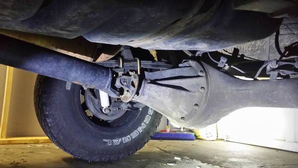

    I would change out that leaf pack. You can see how much stress that block is putting on it.

    Did you happen to install a new set of UCAs?

    It would appear to me the factory leaf packs is the source of the problem. Because they are no longer supporting the truck properly and have literally reversed giving you negative arch, the taper on the block is not doing what it is supposed to be doing and instead adding to the problem by placing additional stress towards the front of the packs. With the stress focused towards the front of the packs the axle is than pivoting back pitching the housing up which is likely shoving drive shaft forward a bit.
    Sometimes an easy solution is just installing an AAL to help keep the packs from going negative. If that doesn't work than your best bet is to ditch the packs and blocks all together and do a new set of beefy leaf packs. I always recommend the Dakars as they are well proven and have the over loads which work great at supporting the packs over time.

    Very well explained. I'm no expert but I would definitely get new leafs. With my 1" block & 3 LEAF AAL I still have "some" arch but I plan to replace my leaf packs later on this year when $ permits.
