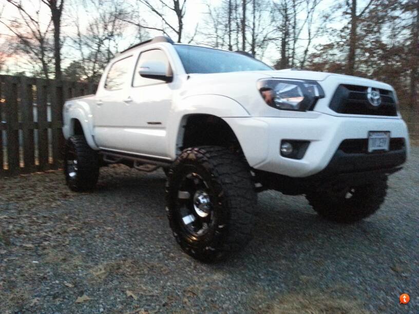

    I had terra grapplers on my tundra and they did fine..I just wanted something more aggressive. .switched to trail grapplers which is what I went with on my tacoma..wanted even more aggressive and more noise..so now have the mud grapplers. ..I'm a huge fan of nitto which is why I run them on my truck and the 4runner is getting them...if you want your truck to look like this go 6" with aggressive 35s...if you just want some lift and a good all around tire do the 4" with 285 nitto terra grapplers..I wanted my truck big and wide..no offroad at all..just looks
    ubehu6es_7282fb608ed27d89fa5823cd522634033a66ec89.jpgerybady5_1b73889de69c70274435e9e07fbb0e4d3dd1298b.jpg3asy5aba_4f50c9f20da34317c441e076f2022084c1a53b02.jpg
