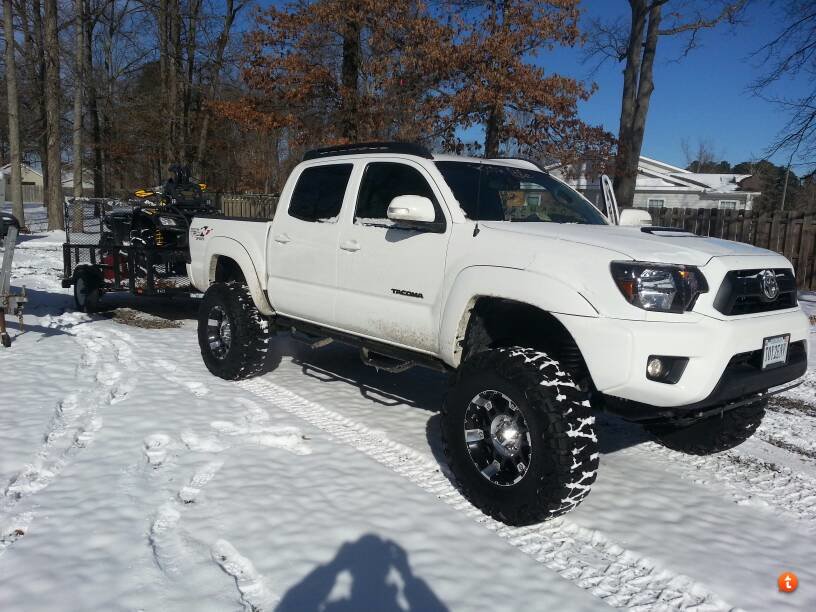

    Haha nice. Mines more of looks as well. Flat trails if anuthing. Did you have to regear once uou got in that 35" bracket? I found some pics of your truck with the tundra rims on a 3" setup and loved the look.

    I loved the look as well..just wanted wider. ..I have not re geared although I need too..4runner project taking up my truck money right now..honestly..I'd go with the 4" setup, tundra wheels, 285/70/17 terra grapplers..I think you'd be very happy with it..plus it will ride just like it does now..later on you can throw a set of bilstein 5100s to improve the ride and even gain some lift if you wanted
