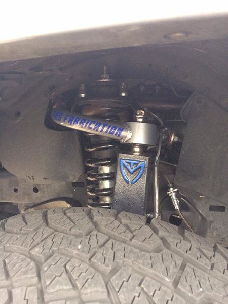

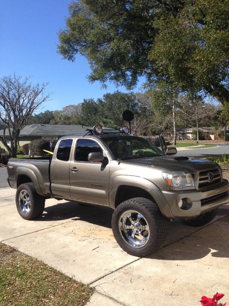

    I don't post in here as often as I perhaps should, but I'm often asked what my lift height is after 4" & Icon 2.5 C/O's. I usually respond with this picture:

    NICE! Convenient beer storage!

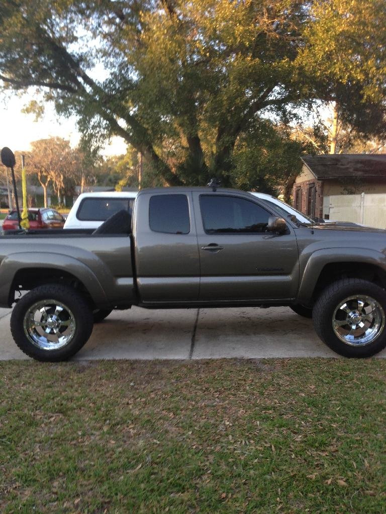

    Well,
    I finally got my Maxtrac spindles (front) & 1.25" Spidertrax spacers, installed on the rear wheels. I already had the Wheelers 3 Leaf AAL & 1" block. Ready to hit some trails! For the observant ones, I still need to align it, secure the ABS lines, & re-install the front skid plate but I'll do that this week.
    Special thanks to CJ (my mechanic) & everyone who responded to my PM's regarding the Spindles & the Spidertrax wheel adapters!

    Looks good :thumbsup:

    Maxtrac Spindles:
    $500
    Spidertrax Spacers/adapters:
    $100
    Wheelers 3 Leaf AAL:
    $200
    1" steel block with u-bolts
    $90
    All prices not including shipping except for the Spindles. Free shipping from Headstrong Offroad. Marie was VERY HELPFUL.
    Also, since I read that they get surface rust easily I painted them with Rust oleum spray paint.

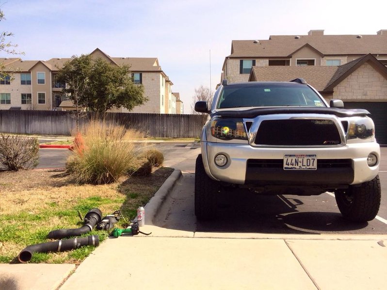

    08 prerunner
    Retro Projectors, tinted tails, nfab nerf bars, avhp4000dvd, kicker 700.5, 2 8" comps, full components front and back, scangague 2, HID Fogs, Muth Mirrors, 5100s front, 90000s rear. Maxtrac spindles, all pro expo pack, level 8 tracker 16" x 8 1/2
    Boom. Did them last night. The brake lines like everyone has states are the worst part

    Spacers made it pop a bit
