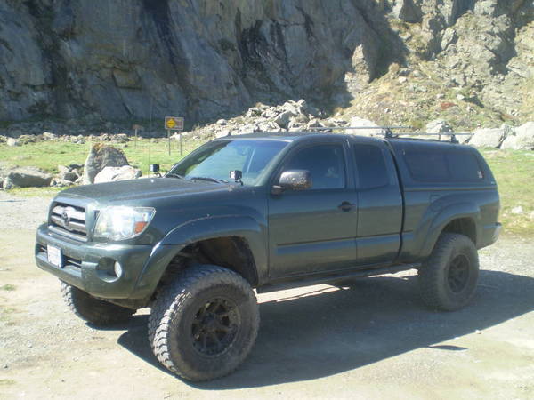

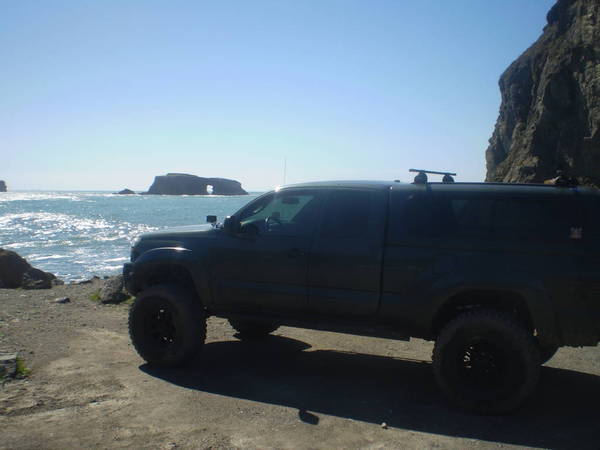

  16. Mar 11, 2014 at 2:30 PM
    #3496
    darkgreentaco
    darkgreentaco XXXL Member
    Jun 10, 2010
    #38712
    2,225
    NorCaL
    Timberland Rocket
    King RR C/O's, Extra mustard, All-Pro expdtn Leaf, sesame seed bun, Icon UCA's Fox Resi's BAMFsliders, sweet candy coating, LCAskids, diffcover 17" Addicts Yukon 4.56 Mt/r kevlar
    Had them on for about two months. Finally got some pics up. Pretty happy with the maxtrac. No complaints.
    Bird33 likes this.
  17. Mar 11, 2014 at 3:03 PM
    #3497
    Mr Salty
    Mr Salty "Give up the good to go for the great"
    Jan 31, 2011
    #50297
    2,288
    Hermmy
    SoCal (Bro Capital of the world)
    White SR5 Pre-runner
    Lots of chrome
    I like this color the more I see it, I hated it when it first came out. Saw some guy with this color and he had it fully decked out expo style, plate bumper w/winch, roof rack, bed rack, RTT, hi-lift, gas cans..... looked so nice.
  18. Mar 11, 2014 at 4:32 PM
    #3498
    Codybobby
    Codybobby Well-Known Member
    Jul 24, 2013
    #108979
    305
    South Carolina
    09 prerunner
    Billet grille, tinted taillights, Injen cai, antennax 13" antenna, Cool white LEDs in interior lights, aero turbine 2525xl muffler
    Nice what other suspension components are you running besides the spindles?

  20. Mar 11, 2014 at 9:56 PM
    #3500
    darkgreentaco
    Jun 10, 2010
    #38712
    2,225
    NorCaL
    Timberland Rocket
    Thanks. 5100's/885's + All pro Expo leafs. I'm gonna throw some fox resi's in the front in a couple of months.
