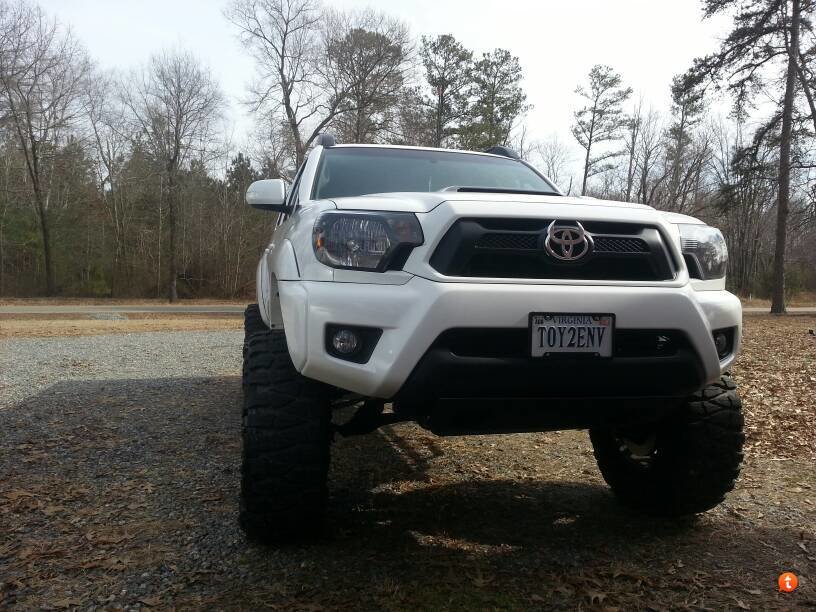

    I know right. That looked like it was pretty cool what you guys did. Good way to knock a bunch of shit out and get some good ideas for future mods.
    Thanks I hope so. Mine are 17" and have 4.75" backspace which is the max allowed for the MaxTracs. So i should be good. You can always get wheel spacers like most people do with these. I'm going to try and not get them, but we'll see what it looks like. It's only 3/4" wider up front and i think it'll look cool.

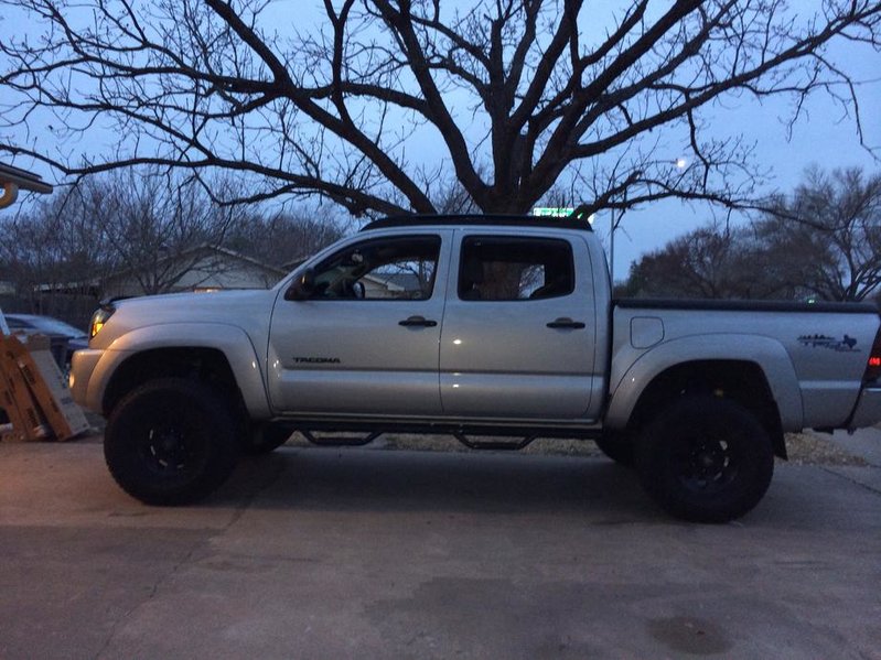

    All right allpro expo pack in the rear and maxtracs on 5100s set at 0 running TRD coils. From the ground to the fender right up the middle the front is an inch lower than the back. All in all not a hard problem to fix. Only question is
    1: raise the 5100s 1 spot and keep TRDs
    2: reuse my 1/2in spacer from my toytec lift
    3: 884s

    You can also just install ome 883's which will only give you about 1.5 lift in front.

    Yeah I'm just thinking about what I already have. Anyone wanna trade 885s for 3s haha

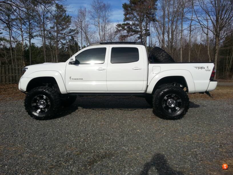

    Well I got my spindle lift done yesterday and am STOKED!!! I have the 4" MaxTrac with 5100's set @1.75 , 1.5" aal, 2" tapered blocks in rear. It's sits just how I wanted it to, about 1" higher in rear and looks awesome imo. Took me ALL day (into night!)to do everything and I was BEAT!! The first side on rear kicked my ass! I forgot to clamp the springs before removing the old pin. Second side was less then an hour. Getting it aligned now. I will put in a 1" drive shaft spacer but it's not too bad right now. I almost didn't go with the 1.75 but so glad I did. Thanks K9cop for your help and advice (and for selling me the!shocks/springs!) I'll post pics later.

    What's your measurements before & after, hub to fender?

    Well I had a 2 1/4" Pro Comp spacer spacer up front and 1" block in rear before i put this on. my measurements with that on was 23/23.5 up front and 24.5 in rear. Now i have those spacers removed and just the spindle as well as 5100's @ 1.75 and a 1/4" spacer drivers side (w/off-road springs) and 2" tapered block and 1.5"aal in rear and i am at 26" front 27" rear. I had just a slight vibration from 5-10mph and after putting in the OME cd drop spacer its gone. I was going to put a 1" driveshaft spacer in because its pulled about 1" out of tranny but since i dont have vibs i may just leave it alone. Now i have to figure out how to lower my headlights.

    Yeah thats weird that my 2 1/4" pro comp raised mine so high. I was happy with it but like you said, i was getting the same hight as a 3" spacer. I would def advise getting tapered blocks if using blocks. That way you shouldn't have to use shims and stuff. I was planning on getting some AllPros too because i didnt think this setup would be as high as it is but i love it the way oit is now so i'll prob stick with it. I have the MaxTrac ext shocks in rear that i also put on yesterday. They feel great but I'll prob get 5100s for the rear later on.
