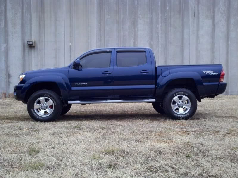

    Here is a pic of my truck as it sits.
    Front-- LR Upper Control Arms, Bilstein 5100 set at 2.5, stock coils = Height 23.5"
    Rear---- Bilstein 5100 Non Adjustable, 2" Toytec AAL = Height 25"
    Now for the newb Questions:
    Other than the 4" Maxtrac spindles.. What else do I need for the front of the truck? Im unsure of weather to use stock coils with 5100 set at .85 or go with the eibach springs and 5100s set at 0. I want a legit 6" lift.
    I dont like the bro lean.. Im more of a stink bug kinda guy.
    What are the parts I need as for CB? drive shaft spacer? Angle?
    Brakelines extensions for rear?
    Should I go with a different shock than 5100 on the rear?
    My tires will be 285/70/17 Duratracs... Will that be big enough? I already have spidertrax spacer 1.25 all around. Any advise would be appreciated.

    I just bought 4 inch maxtrac spindles with ext front brake lines, and for the rear I got a 2 inch block and billies. I was wondering if this setup will get me level or will i be sitting front end high?

    Should be level.
    Actually could be rear high a tad. The spindles only yield about 3.5"

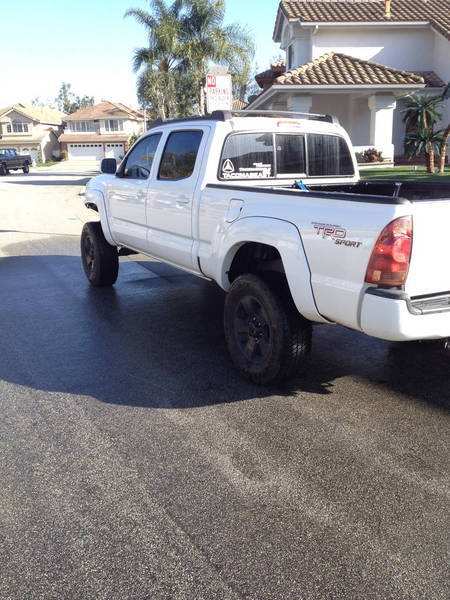

    Just Lifted my truck after watching this forum for a couple of months.
    -Maxtrac Spindles
    -EMU Dakar leaf Pack
    -5100's all around (Front Set at 2nd Notch)
    -1.25 Maxtrac Spindles
    -Extended brake lines all around.
    I have a set of 315/75/16 that I'm waiting to put on but I have a couple of questions.
    1. Do I need to do the cab mount chop?
    2. Will 315's fit in the rear without trimming?
    Thanks Guys

    Rear will be fine. The front is going to need the cab mount chop.

    Looks good I have that same setup on the way estimated to be here tomorrow any side pics of your truck?
