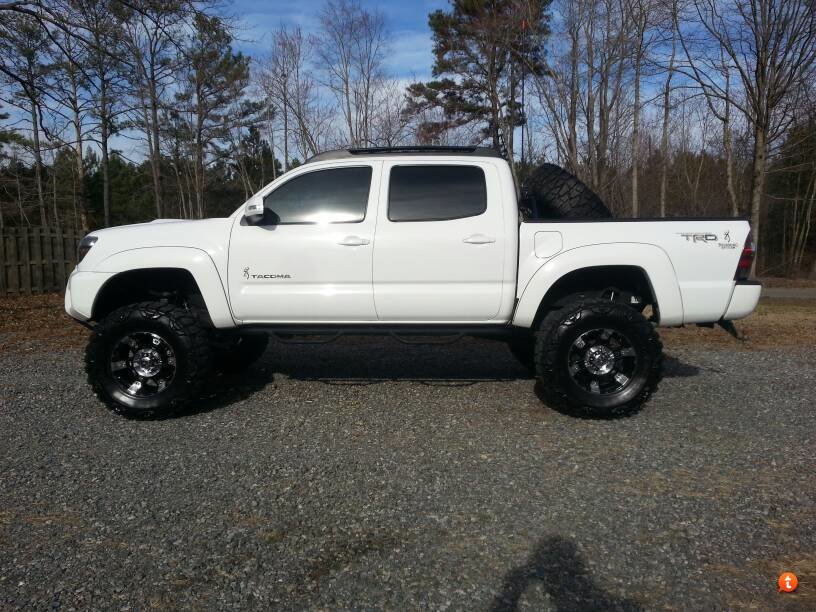

    That white bumper looks like shit. Let me have it

    They look cool but don't seem too practical without fiberglass. Round here, we like to run through the desert and I'm afraid when the suspension compresses, I'll crumple my fenders...
