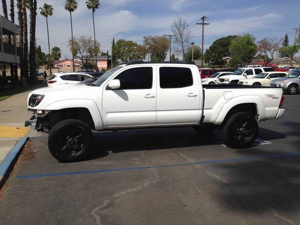

    TopGuns
    TopGuns Well-Known Member
    Apr 22, 2013
    #102632
    281
    Kevin
    So Cal
    08 Mid Travel
    Mid Travel, Satoshi Grill, Halo Projector Headlights, 2x 10" Kicker Comps, OEM Roof Rack,
    Ok Cool, Thanks.
    Here's a side pick of it.
    And what bumper are you referring too?

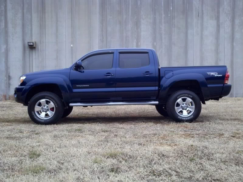

    I know this thread is long.., but has been full of valuable information.. With that said I feel it would be a great addition if you Maxtrac spindle guys could give real measurements and setups to help us guys putting all or parts together for the lift we want ie= bro lean, level, or stink bug.
    Measurements should be from center of wheel hub to fender to take the variation of tire and rim size out.
    Example
    Me
    Front-- LR Upper Control Arms, Bilstein 5100 set at 2.5, stock coils = Height 23.5"
    Rear---- Bilstein 5100 Non Adjustable, 2" Toytec AAL = Height 25"
  20. Mar 20, 2014 at 7:46 PM

    A few things
    Front-- 4" MaxTrac spindles, 5100 Billies @ 1.75, stock (OR) springs, 1/4" spacer on Dr side = 26"
    Rear-- 1.5" Toytec aal, 2" Tapered block on 4 leaf tsb springs, ext shocks = 27"
    Mine sits 1" higher in rear but looks level. I had my truck perfectly level with front before and it visually seemed low in the rear. Nothing wrong with that look, it just depends on the look you're going for.
