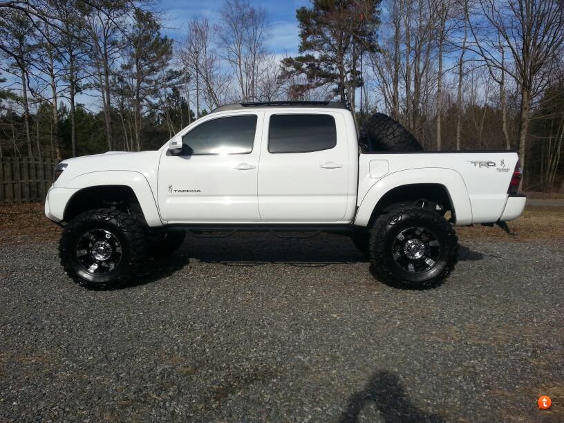

    Sharp lookin truck!

    Front: Maxtrac Spindles, OME 885 Coils, Bilstein 5100s set at 0, Toytec 1/4" spacers both sides
    Front Measuremnt: 28"
    Rear: 4 leaf tsb springs, 1.5" aal, 3" block
    Rear Measurement: 27.5"
    35x12.50x17s
