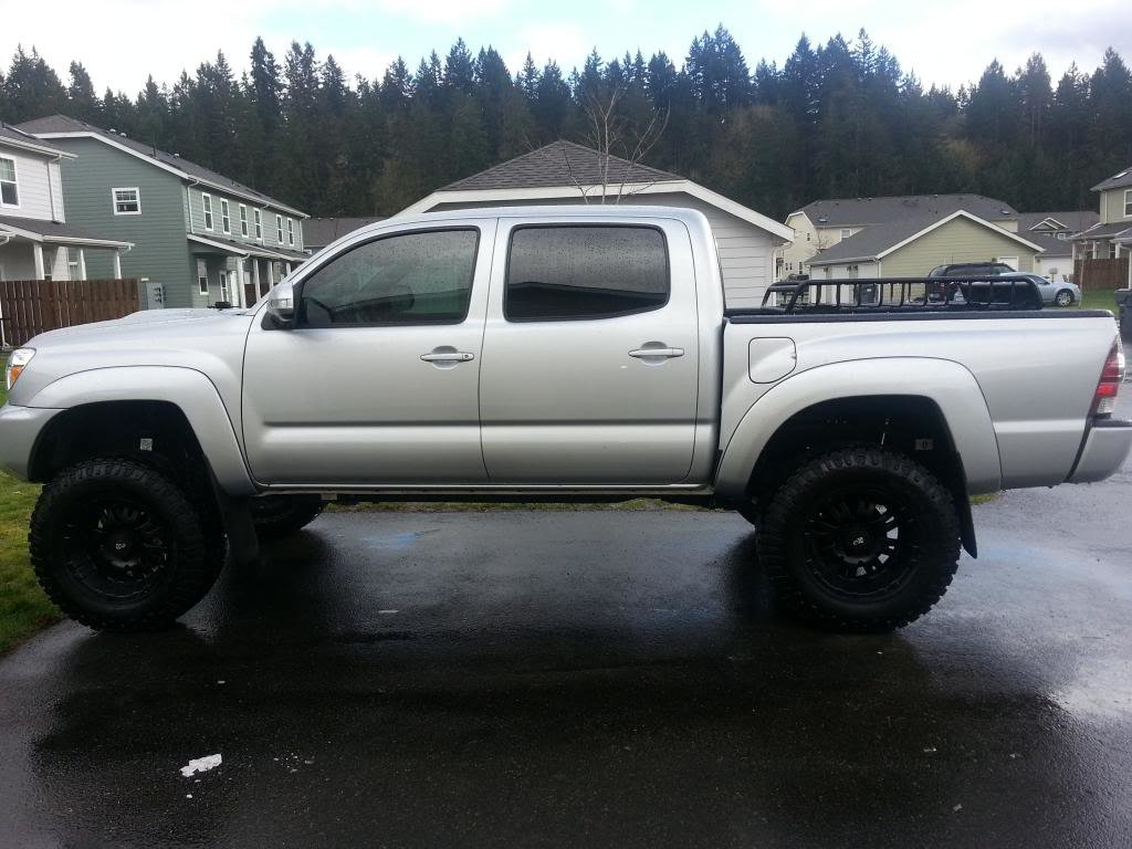

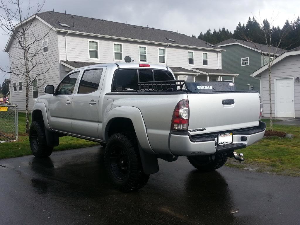

    Whats your hub to fender measurements front and back?
    Ive decided to go 1.75 on my billys with stock coils. My Maxtracs will be here Monday. Just curious measurements to gauge it.
