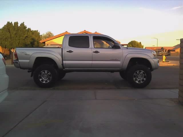

    Zoomed the shit outta my phone..

    looks good mangg!!

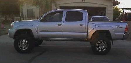

    Definately not digging the high ass..should i set my billys to .85, get eibach/toytec springs and top plate spacers for a huge monster lift? Hah...

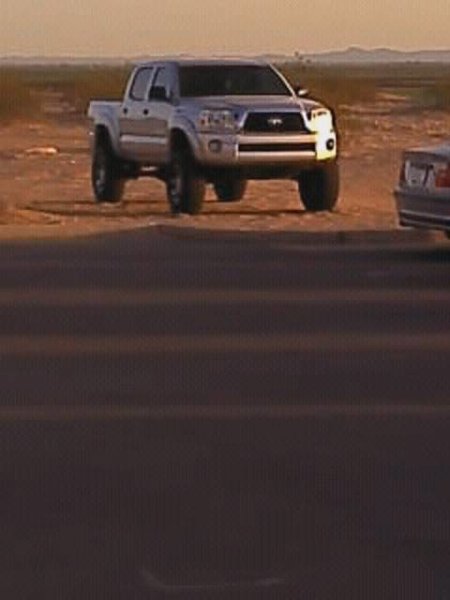

    And another...sorry for the thumbnails...im uploading quickly with my phone..

    Doesn't look like your rear is higher :confused:, you're saying you wanna lift the front more? I had my Eibachs at .85 prior to spindles, and 1/2" driver side & 1/4" passenger spacers. Felt quite stiffer than it does now set at 0 (plus had a lean the other way, guess too much spacer correction?) I believe eibachs are stiffer than stock spring by quite a bit hence why not recommended to preload any more prolly

    Its abt an inch higher...yeah eibachs are rated at 620 i believe..my bro is getting that setup...ill see what his truck feels like..mhis is an access cab tho and wants the full 3" inches..

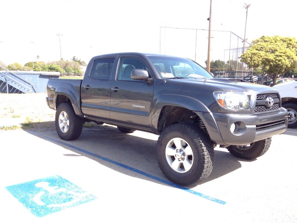

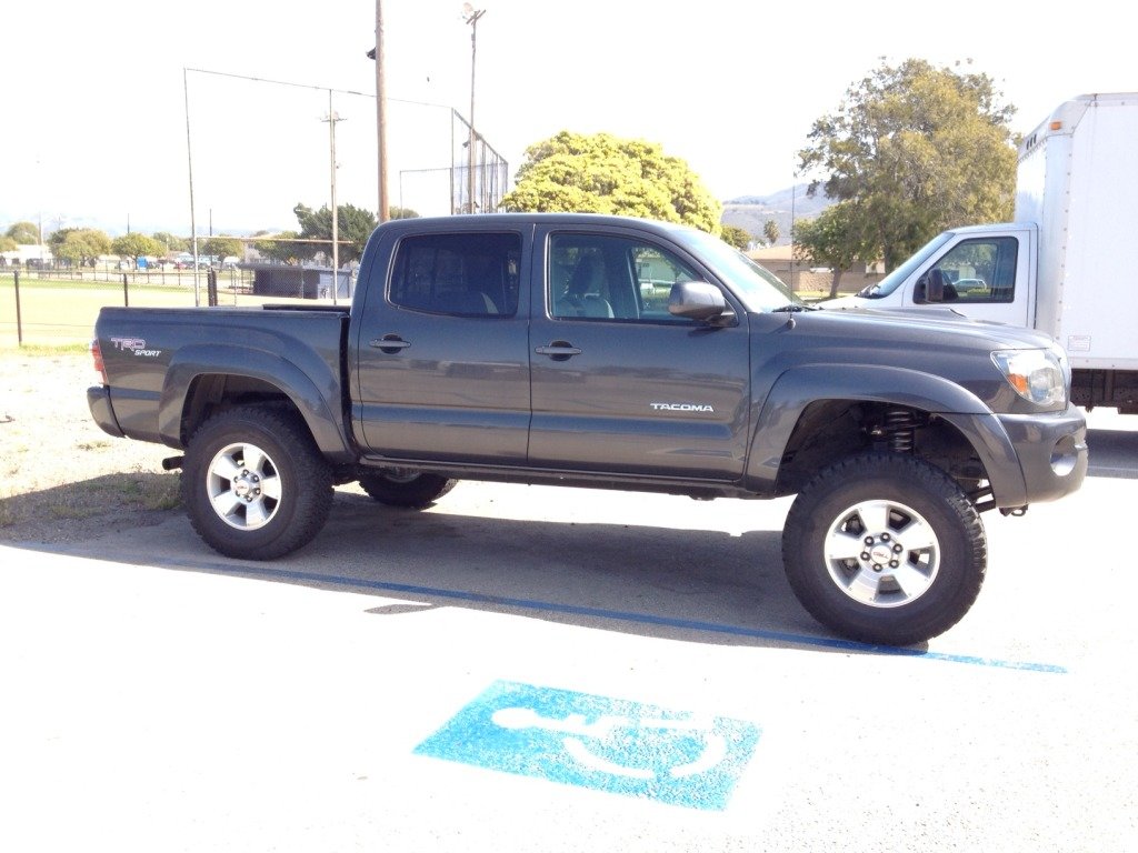

    Here's a couple of pics so far...
    Front: Light Racing UCA's and Maxtrac Spindles, 5100s/Eibach set at 0.
    Rear: TSB + 1.5" Toytec AAL (soon to be 3" All Pro)

    And eddy, that looks perfect in my eyes...little lean..
