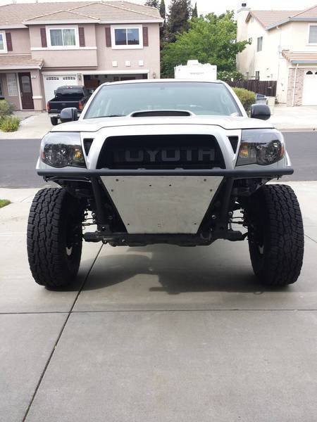

    Vacaville
    2014 Tacoma TRD Offroad
    Hnnnng so sick!
    Front end picture :cool:
  10. Apr 21, 2014 at 5:32 PM
    #3870
    TRDrunner
    TRDrunner Well-Known Member
    Apr 8, 2013
    #101668
    1,196
    Victor
    Vacaville
    So awesome! :D
