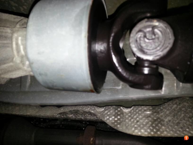

    A few things
    Judging from that pic your driveshaft spacer will probably be around 1". Like mentioned above just measure how far out that yoke is from being flush. You don't want it any deeper then flush.

    just went out and measured the yoke, and ya, its right at 1" from being flush
    and thats assuming im measuring the correct part basically the back part of the yoke needs to be flush with the tail housing correct?

    Yup, should look basically like the pic that was posted above

    Yep just like thisgy3usu8u_8d61b0b62e08d2634d0dd513a830f15726eed91c.jpgubamabu8_26243e87f2a528ada6a88dc9feefc77a1aa7e364.jpgmupuzepe_8ea3a05f4dec618bbcbc7a3bedfd04dcf9dcfe3c.jpg

    awesome thanks, I just ordered a 1" spacer for the DS, I guess now i need to get some 3* shims and see what size CB drop I need if needed
