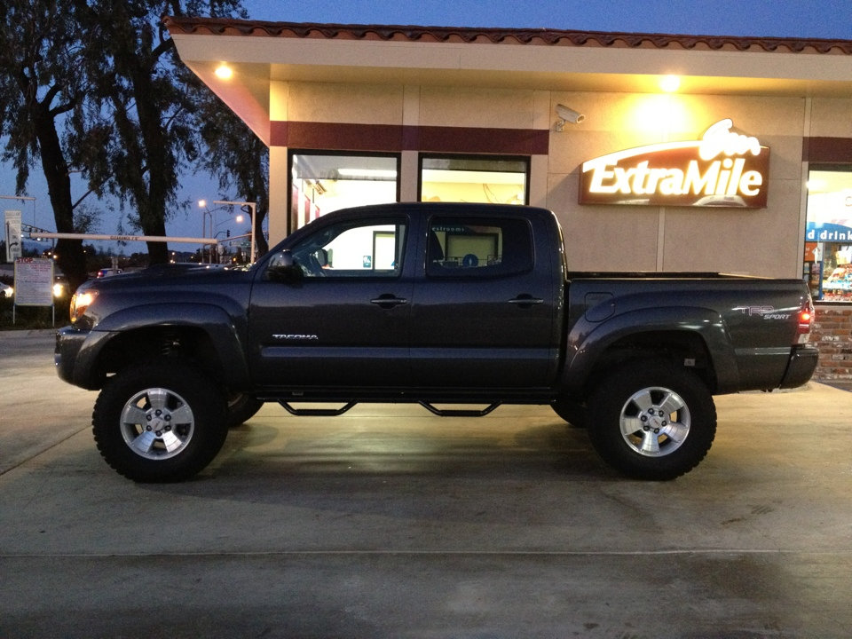

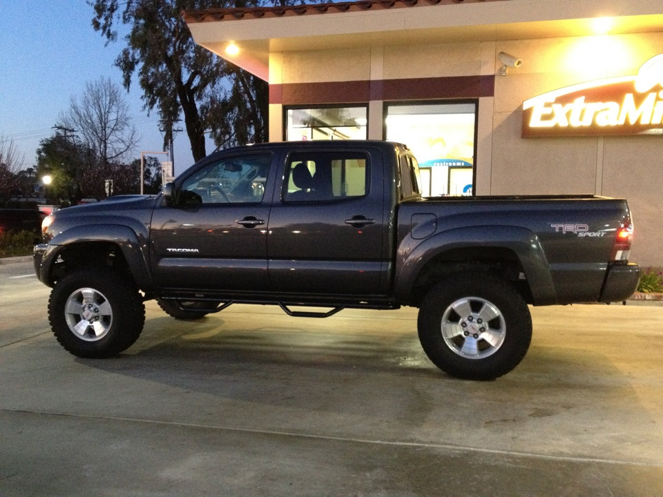

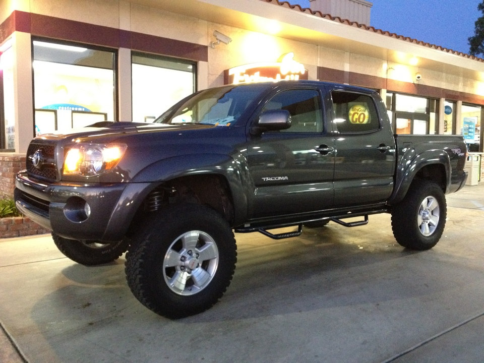

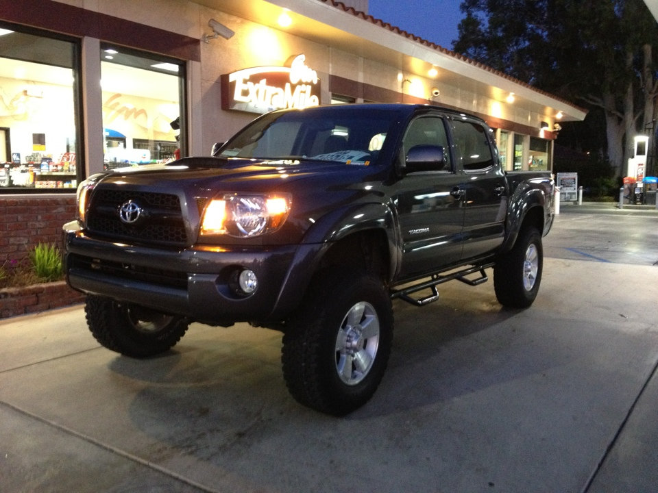

  13. Mar 2, 2012 at 11:15 PM
    #433
    Relik
    Relik Well-Known Member
    Nov 8, 2010
    #45891
    602
    Eddy
    Thousand Oaks, CA
    '11 TRD Sport PreRunner-Auto-Magnetic Gray
    Bilstein 5100s (Front & ext. Rear), Eibach coils @ 0, MaxTrac 4" Spindles, Light Racing UCAs, 1/4" lean spacer, All-Pro 3" Standard leafs, u-bolt flip kit, SpiderTrax 1.25" wheel spacers, 33" (285/70/17) TreadWright Warden A/T tires, extended lines
    Ok boys here's some more pics for the thread. Spindles are awesome! Really sat well after I got the rear in. Very slight lean but I'm really liking it. You can see more clearance in the front fender wells but the truck sits even. The bed top is perfectly flat so makes it seem like how it's supposed to be. Also my new N-fab steps showed up today! Popped them on... Here's what I just got on:
    Maxtrac Spindles
    5100s all around with Eibach coils upfront set at 0.
    Light Racing Upper Control Arms (set at -1 (+1* caster))
    All Pro Standard 3" leaf pack + u bolt flip kit
    N-fab step rails (for the shorties...)
    Have Sport stock 17" rims with 33" tires and 1.75" wheel spacers. Width and stance is perfect, I'll add a front shot later... but it's flush!
    Need to measure rear flex for new shocks. 5100 is too short.also bumps though I did put my stocks back on. Also ended up keeping the sway bar off.
    Ride is a loot better with Eibachs at zero. Had them at .85 and spacers, was more firm. Before that had @ 1.75 with stock coils. Eibachs have been best now at zero, can't wait to see it off road. Rides real solid and smooth now. Loving the lift!!!!
    Oh and alignment numbers:
    Camber:0
    Toe: 0
    Caster: 3.5
    Still got to tackle abs issue tomorrow...
    Shooter808 and ChadsPride like this.
