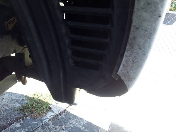

    Hey guys, I got my maxtracs on last month. I have 285/70/r17 Toyo Open country AT2. With wheel spacers, Almost forgot
    Seems like I've had to do a fair amount of trimming on the fender on both sides of the front fenders. Rear wheels are fine. Couldnt get a good picture of it right now, Ill try get a better angle later.
    This look normal to you guys with my setup? I have to cut the hump off the bottom of the inner fender dust cover thing too.

    You get more fender rub from having those spacers. When i was runnung 33's without spacers i rubbed, but not bad. I added spacers and rubbed so bad i had to do my CMC.

    Ok, Yeah i was just curious. At full lock in reverse it rubs. Ill have the do CMC soon. i figured it was the wheel spacers thats giving me that extra rub.

    I had 265/75r16s mounted on 4.5 bs rims with 2" wheel spacers...and I rubbed my bumper and CM like crazy, but not anymore now that all the spacers are off

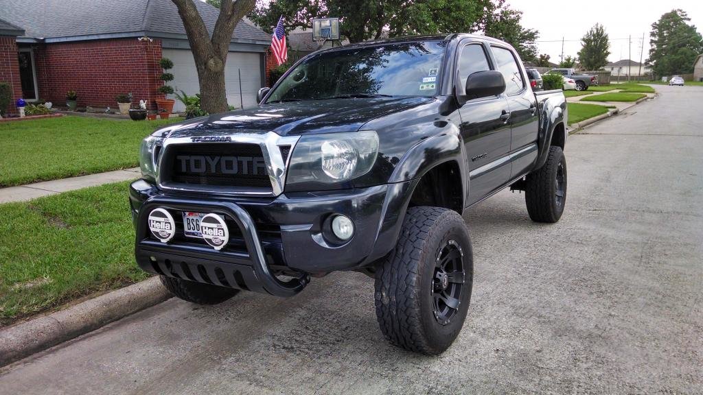

    Here is mine with Maxtrac Spindles and 5100's set at 1.75 :)
    I have a question for some of you guys. I am planning on upgrading to 885 coils with my billies but am still debating on going with the eibach and billies set at .85. Which ones should I go with? Leaning towards 885 but want to here what you guys with mantrac spindles say. Thanks! :D Plus I already ordered a hybrid bumper from SOS Offroad Concepts and might add a winch in the future.

    Spidertraxx 1.25" spacers in front and rear, 4" Maxtrac Spindles,Billy 5100s at 0", OME 885 Springs, 1/4" top spacer on both sides, 1.5" AAL, 3" Block, 1.5" 4crawler driveshaft spacer, 17x9 XD Spys with 35x12.50 Nitto Mud Grapplers, Magnaflow offroad Stainless Exhaust, Volant Intake with scoop,Camo emblems, BHLM, Tinted tailights, Anytime fog mod,Alpine Type R 12, Kicker 1000 watt amp,600 watt 4 channel memphis and all memphis components, 35%tint front all the rest at 5%, Hella 500s with sylvania zxe bulbs, sylvania zxe headlights, sylvania zxe fogs, Weathertech digi fits, flyzeye blue/white, LED map dome license plate lights, Redline hood struts, Tailgate EZ Down, Custom TRD Camo Browning Edition Bedsides, Camo wet okoles, Ridgid Dually bed lights, SOS Concepts Tire Carrier
    I had the bilsteins at 1.75 and eibachs and switched to bilsteins at 0 and 885 coils plus a small top spacer...rides so much better
