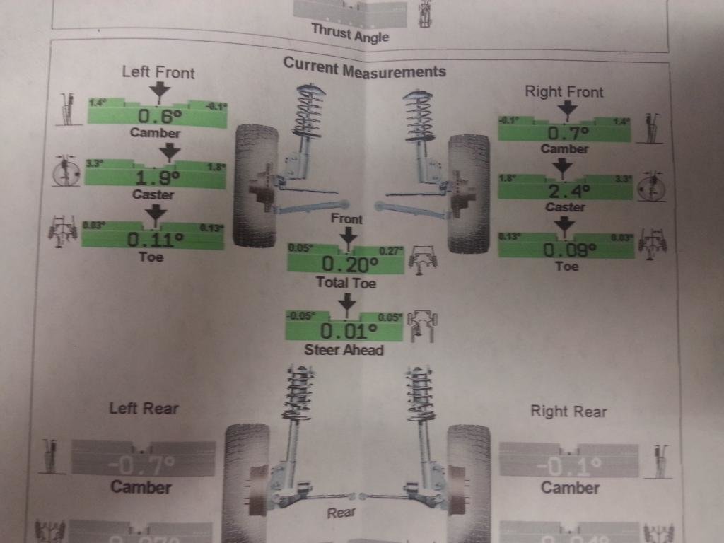

    Anyone have pics of how they trimmed the plastic fender pieces. Dont want to cut and it look dumb

    Do they need to do some more on caster or this ok. My truck isn't level so maybe it could be throwing off the specs

    I always tell them to try to get my specs to this:
    Camber: 0
    Caster: 2.8 (2.5-4.0)
    Toe: 0
    It's a lot different then factory alignment specs but i guess for lifted trucks with bigger tires this is whats desired.

    Thanks rick. Ive called them and they said to bring it in and they will see if they can get the numbers to 0 0 2.5

    Just my 2 cents here.... Setting toe at 0 would make the steering a little sluggish... Usually you want to set it 1/8th in because at speed the tires have drag on them and the toe will be at 0... When it starts at 0 then at speed the tires will be a little toed out... Just an idea..... Thanks

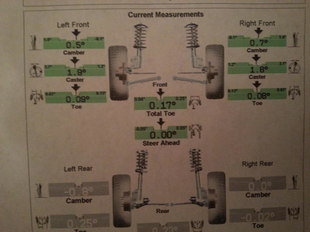

    Round 2
    Driver side is still the same wtf

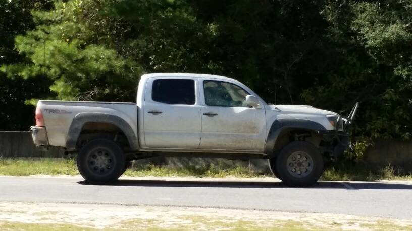

    Here's mine, I have 265/75r16 terra graps which they equate to about a 31.5" tire. My ICON coilovers are set to damn near nothing, so the spindles are giving me about 98% of my lift
    It honestly looks funny with the tiny tires lol, I want 35s to fill the space haha
