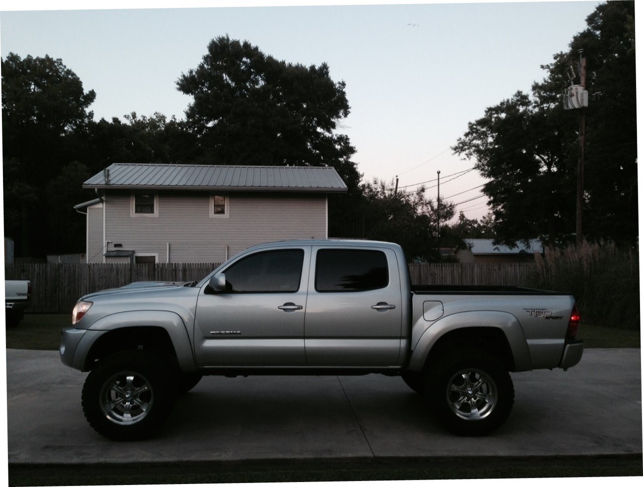

    black billet, Fog light mod, DTRL mod, K&N filter, Dynomax Super Turbo, 5100s with maxtrac spindles, Enkei 18s on 33s, HID and LED lighting

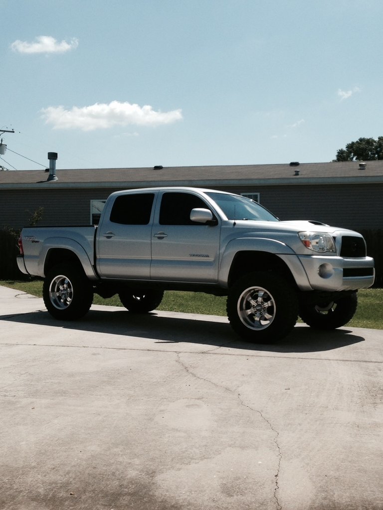

    spindles and 5100s at .85 with 3 inch block in rear. i put .75'' BORA wheel spacers in the front also ( had to overnight them bc truck was stuck in the shop, couldnt put the wheels back on. thought my wheel offset would clear ) Cut out all the black inner fenders and still rub right on the corner of the actual painted part of the fender. But overall im loving them so far!

    I'll never get tired of thos toyos!! What's the setup in front and rear?
    Bummer about the rubs. Other than that, very sic!! Wheels are prime!

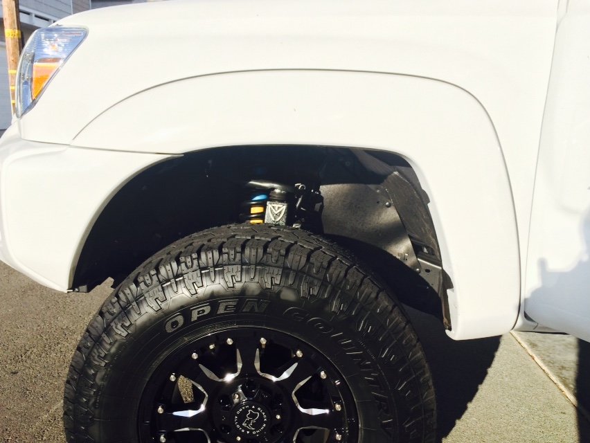

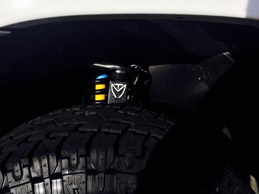

    15% TINT, CUSTOM 3IN CAT BACK W/ A DYNOMAX MUFFLER. 4IN SPINDLE LIFT UP FRONT, 2IN BLOCK IN THE BACK. STOCK STRUTS AND COILS. 285/70/17 TOYO OPEN COUNTRY AT2, 17X9 BLACK RHINO SIERRA WHEELS
    Spruced up the spindles with a little touch up paint.
