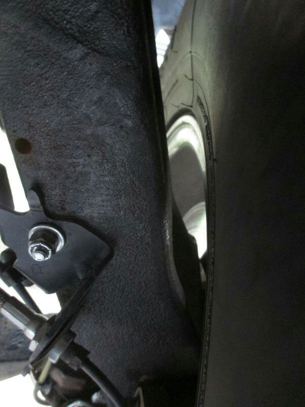

    to park I always turn all the way... so 16 rims couldn't get the backspacing needed?

    I have 16 inch rims with 4.5" BS and I clear the spindle and no rubbing

    but 4.5 is the max spacing and you need 4.75?

    I would honestly go with saying 4.5 is the minimum back spacing you'd need. Not sure if 4.75 would fit or not, but my 4.5 seems way too close as it is. It might...but it would be waaaay too close for my liking

    Totally late reply, but the caster should be moved forward to avoid kissing the pinch weld. 3.5-4 degrees will help and if anything completely clear it. I had the same wheel tire size before and had my caster set to the above. My current 305 tires are rubbing pretty bad on the pinch weld and fenders and I've cut a lot of plastic and also have the cab mount cut and welded. Only happens when I turn and hit something hard.
