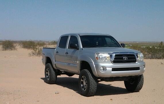

  15. Mar 7, 2012 at 12:41 PM
    #515
    markmatters
    markmatters [OP] Viejon
    Nov 4, 2011
    #66436
    1,311
    Mark
    Yuma, AZ
    2007 PreRunner
    More..
