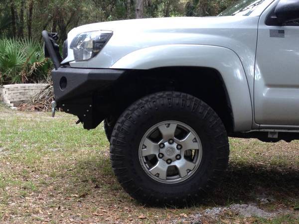

    pbjeep,
    Here's what I have at the moment:
    Let me know if you have any ?'s

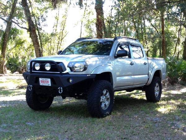

    That's the look I am after. what size tires are those? You running spacers front and rear?

    They're 285-75-16 Duratracs and yes, 1.25" Spidertracks front and rear.

    That's exactly what size I have been looking at or the 255 85 16. How much rubbing and trimming did you have to do?

    Had to trim a bit off of the rear of the fender flares in the front. I'll post up a pic in the daylight hours. Only noticeable when you're looking directly at it from behind the tire. Other than that, no rubbing and I regularly run thru off-camber ditches and stuff while hunting.

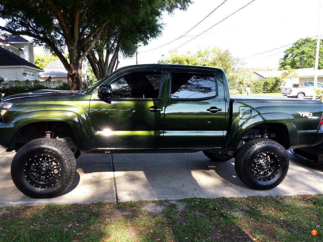

    Good deal. So will I need a drive shaft spacer or carrier bearing drop with the spindles and blocks only? What about the driveline vibs are having, how do you get rid of that? I want to do this right all at once. I have a 2015 double cab short bed 4.0 auto.

    If your just doing the spindles & a 2" block you shouldn't need a driveshaft spacer or carrier bearing drop but you will need longer rear shocks.
    My first lift was a crapy 3" spacer lift with 2" blocks in the rear & I didnt need either of those. I kept the stock rear shocks & I could feel them top out(fully extended) from time to time on certain bumps ( on the street)when the rear end would drop.
    This is with the crapy 3" lift & 285's no trimming & only rubbed in reverse at full lock. Just to give you another idea how it would look, 1" higher in front of course.
    How she sits now.
