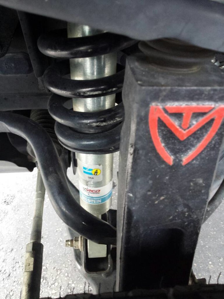

    Are they talking about a different model of Bilstein? The 5100's aren't designed for stock height? why would they have different settings?
    If they are talking about 5100's not working with spindles you can show them this pic & tell them they're idiot's & don't know what they're talking about.
    5100's set at 1.75, not stock & spindles living in harmony under my truck. Haha

    speedway blue 09 prerunner sport 2wd
    brite ass led headlights and fogs, fuel hostage wheels, mellow tone dual exhaust, black westin bull bar, go rhino nerf bars, toyota neoprene black and blue seat covers, image dynamics door speakers all around, Bilsteins 5100s all around set at 0 with maxtrac spindles and eibach coils and total chaos UCAs with OCtaco brakelines all around and all pro expo leafs in the rear running 295/70/17 cooper ST Maxx, cobra cb radio w/ 3ft fire stik, bed lights, jvc double din head unit, AC in cab mod, AFE CAI...more mods to come
    Yea they said 5100's and it threw me off so I told them I would go home and double check that. I'm going back thursday and show them this. BTW how do you like the ride on the highway? Is it smooth?

    No problem. I've got the expos & a 1.5" block with 5100's & Nammer has the standards & a 2" block with 5100's.
    We both have model BE5-B110-T5 for a 4"-5" lift. I didn't see where it says 5100's won't work.

    The only reason I can think of why they told you this is because bilstein does make a longer 5100 that is used on the rcd 4.5 db lift kit. That particular shock won't work on the spindle lift but on any db lift as I ran them on my truck when I had it. The stock length ones that everyone is running with the 4 settings most def will work with the spindles. I would probably stay clear of that shop.
