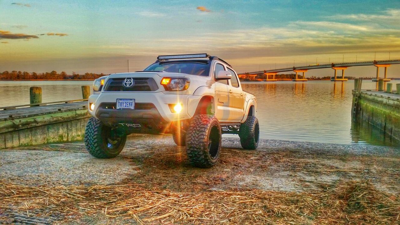

    That ground clearance :cool::eek:

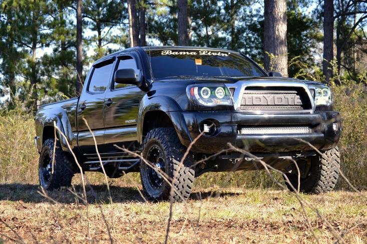

    Okay, I really need help.. I have a 2005 tacoma DCBLWB with a 3 inch leveling block on the front and 2 inch add a leaf in the rear!! Eyeing the 4 inch maxtrac spindles really hard with a 1.5 inch block, I have 285/70/16 trail graps with 1.25" wheel spacers, wanting to keep same tire with this lift!! Anyone have suggestions? I just want the lift for looks and better ride!!

    those should fit with the maxtracs, I have 4.5" BS on my 16s and my 16s clear the spindle, so your 1.25" spacers with the 16s will work. and also since the maxtracs give .75" track width, you dont have to worry about the UCA being rubbed by the tires

    bump added pic, guys just let me know!
