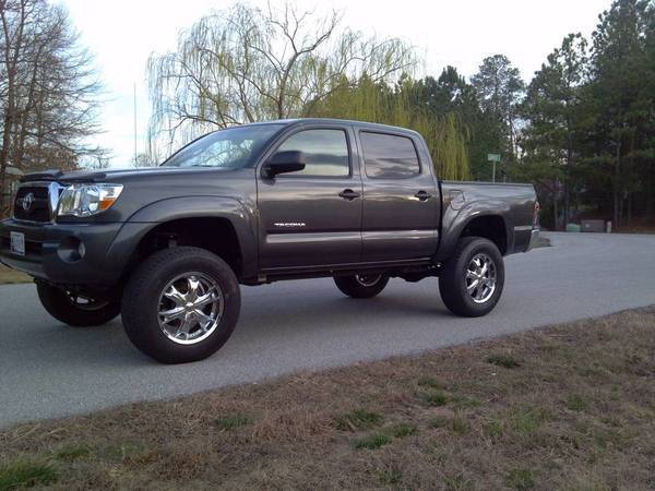

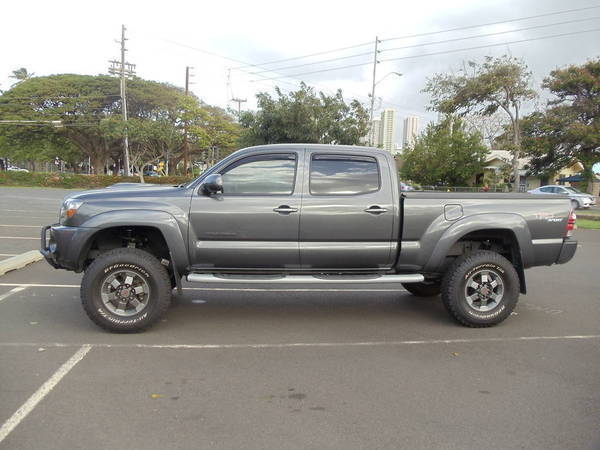

    I went to shop to install 2 days ago.
    Maxtrac & Toytec 1/2" top spacer & billy 5100 (0" setup) 1/4"Wheel Spacer
    Rear Toytec 1.5" Block & 1.5" add leaf & TSB Leaf & Billy 5100(Extended) 1" Wheel Spacer
    Now rear is about 1" higher.

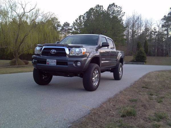

    New Taco: 96 DLX Extended Cab 4x4 2.7,MT, Bilstein 5100s at 2.5 and HS 3 Leaf AAL Old Taco: 11 Prerunner Maxtrac Spindles in the front, 2'' AAL with Bilstein 5100 extended in the back. 18'' Milanni Stellars wrapped in 265/70/18 General Grabber tires.
    Are you running stock coils in the front? you didn't say in the above post. I am thinking you're running eibechs based on the fact that you have a block, AAL, and TSB and you are about even.

    Looks good! I have stock coils.

    Running stock coils.

    ah, the half inch top spacers, I didn't see that the first time. That's the extra umph in the front. It looks really good man!!
