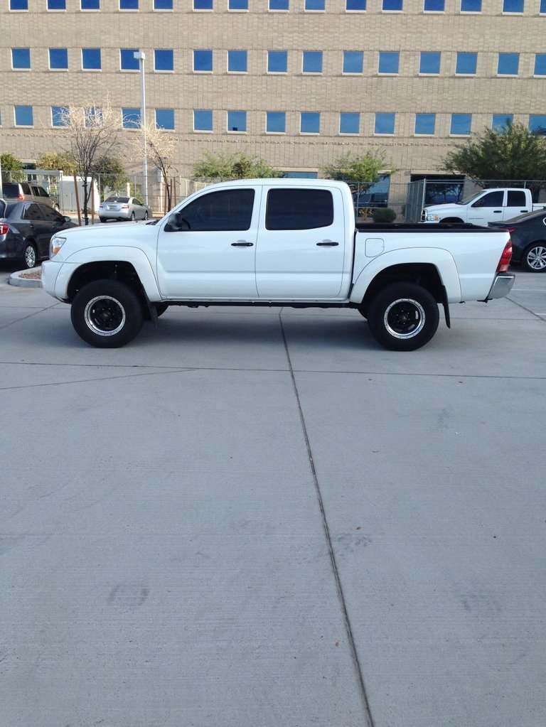

    Ordered my spindles from Headstrong on Monday. Can't wait. How she sits right now:[​IMG]

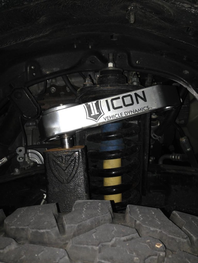

    Soooooo Juanito and I did a thing tonight . . .
