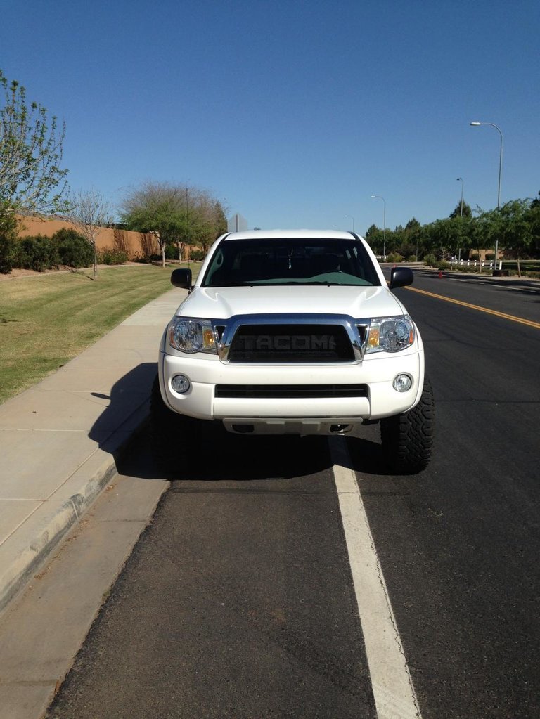

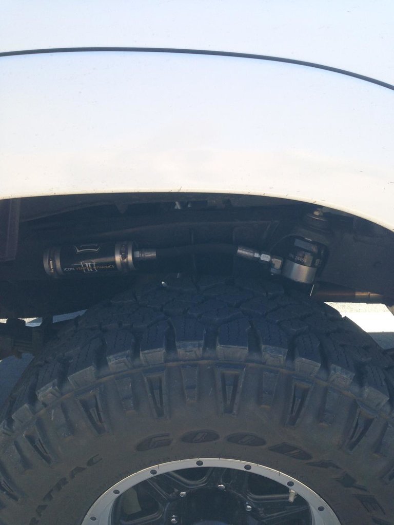

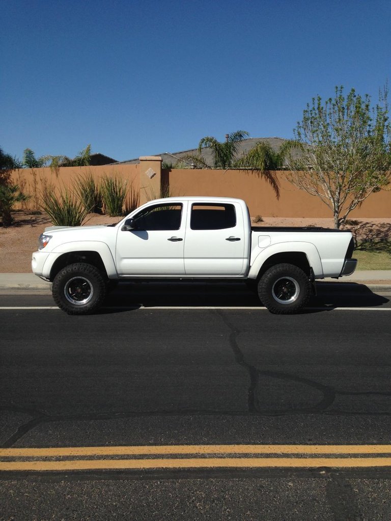

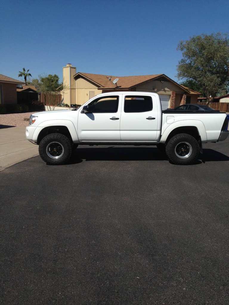

    Nope. I have the standard non tsb leafs with 120k miles on them. Here are some pics. Maxtracs and bilsteins at 1.75 with Deaver 1.5 AAL with 2" block in rear.

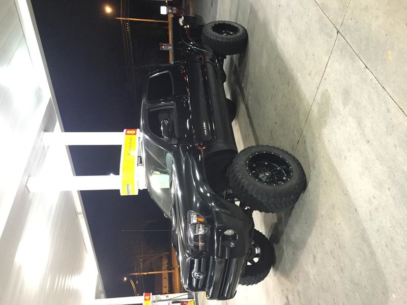

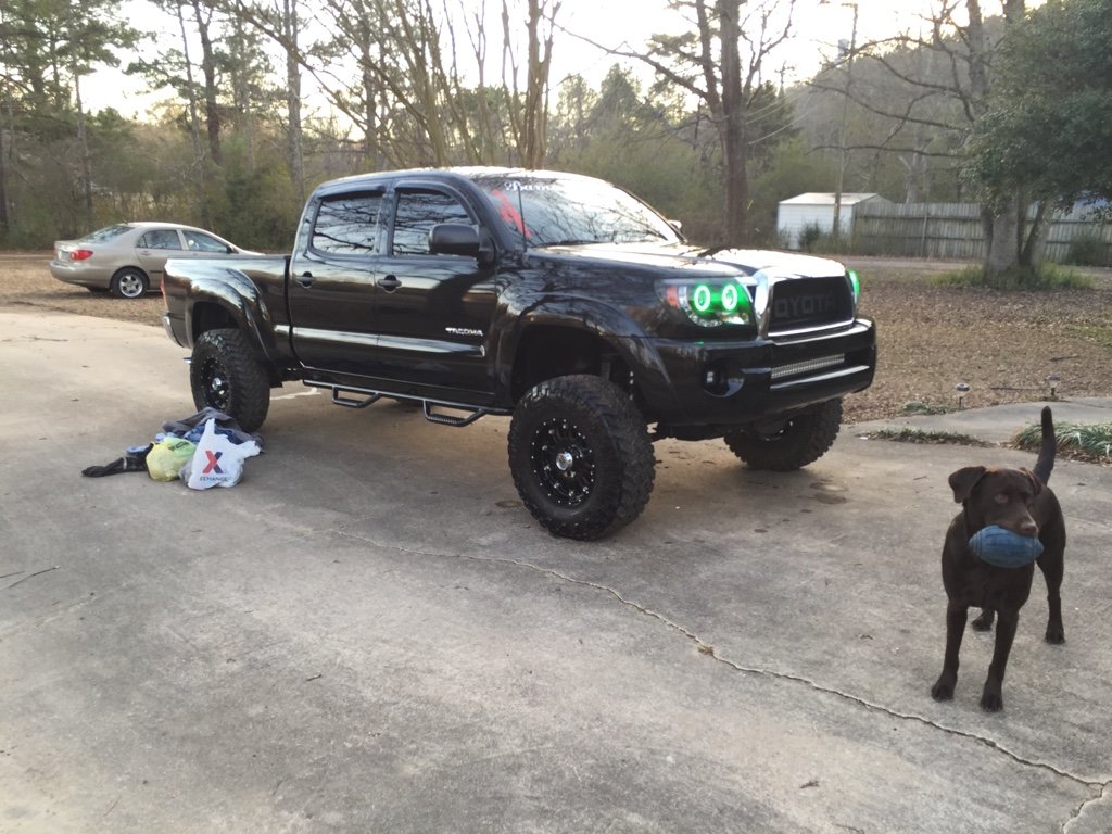

    Man I love how it looks! Mine has 4 inch spindles with Bilsteins at .85 and a 2 inch add a leaf in the rear. When I get bigger tires I'm definitely doing this!
    My truck now:
    433ee1192474764691f79ea981130355_599087bcbaa05670c278f2cf0fcffcb9d2149011.jpgd3053ee0684155ff863e74c583c82cdf_93b5b3283f2992e9720dad8db0360ee39a34d595.jpg

    I've seen your truck on Instagram before, haven't seen it with spindles yet, looks really good.

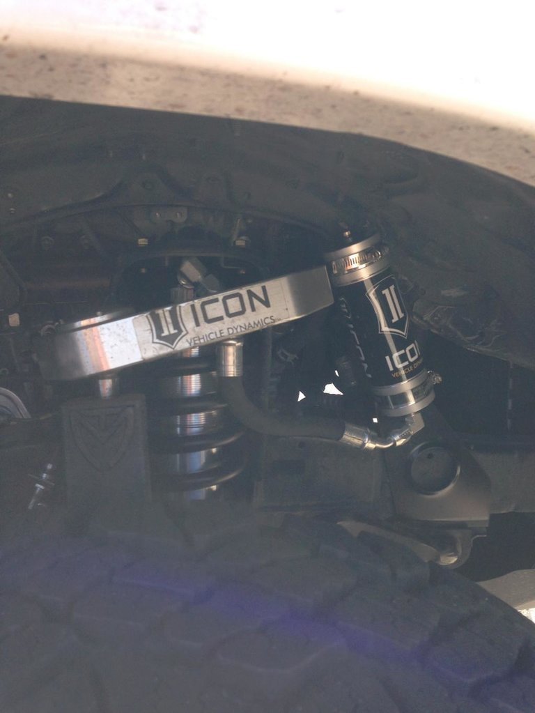

    Finally finished the BT last night,
    Icon 2.5 RR on all 4 corners,
    Icon 3L AAL bolted onto Toyota 3L Pack With Over Load Leaf,
    Icon Billet UCAs,
    MaxTrac Lifted Spindles,
    Here she sits with the COs set at 0.
    Tires are GoodYear Duratrac 285/75/16 on 16" L8 Strike 6s W/4.5" BS
    Dead Even Front to Rear -
    Icon Billet UCA + Icon EXT Travel 2.5 Remote Resi (Set For Zero Lift) + MaxTrac Spindle
    Icon 3L AALs On Tacoma 3L Pack With Over Load Leaf + Icon 2.5 Remote Resi (0 - 3" Lift)
    Kinda happy about how she turned out, with the COs set at Zero the ride feels very much like my drift spec 350Z that was equipped with full Tanabe suspension . . . Well except with more more ground clearance and the desert running at speed.

    That is what I envision for my suspension when she's paid off. Looks great but performs even better I'm sure!

    Thank you sir and if you go this route ( Icon Stage 5 ) you will be very very happy you did . . .

    Looks great man! I love my Icons and Maxtracs!! With that coilover spring rate you can remove that sway bar with no problems at all. I was a little hesitant when I removed mine, but soooo glad I did. I've taken sharp corners at speed with no crazy leaning or anything like that. With stock springs its a different story. Probably one of the best "mods" 'I've done. Feels so much better.

    Agree with you 100% and to be honest it's hard to put into words how different the truck feels now. What I do know is there are no regrets ! ! !

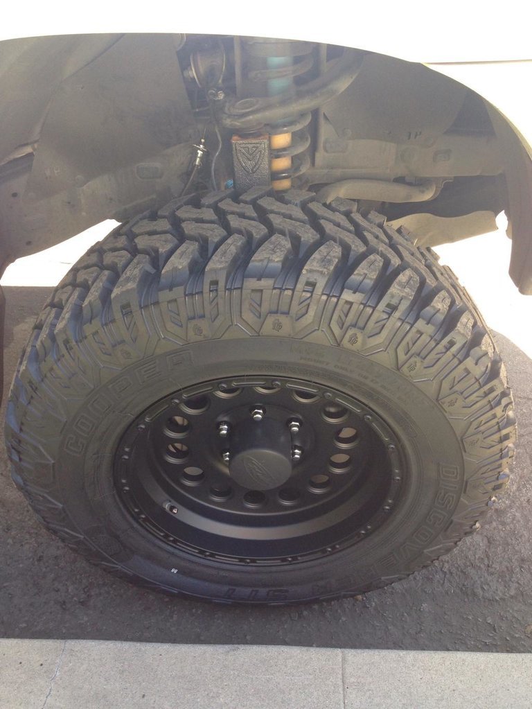

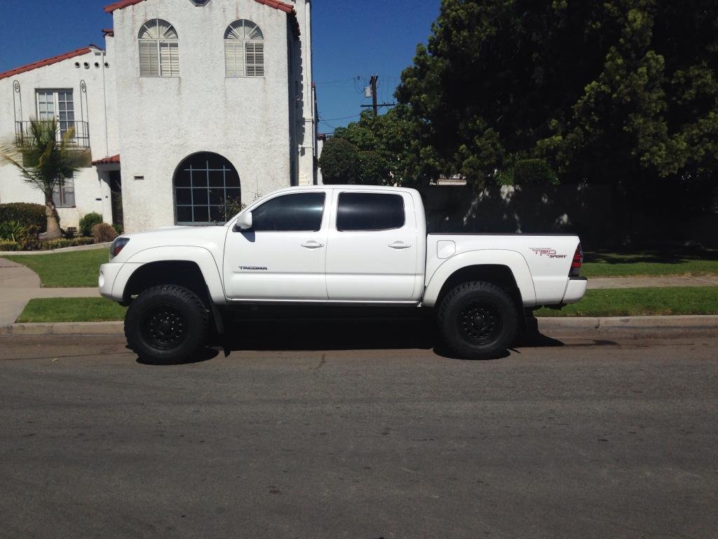

    New wheels and tires!

    Looks good!! How those tires ride? They loud?

    You can hear them but they're not too bad. I crank the radio anyways so it's not a big deal.

    Looks Great ! !
