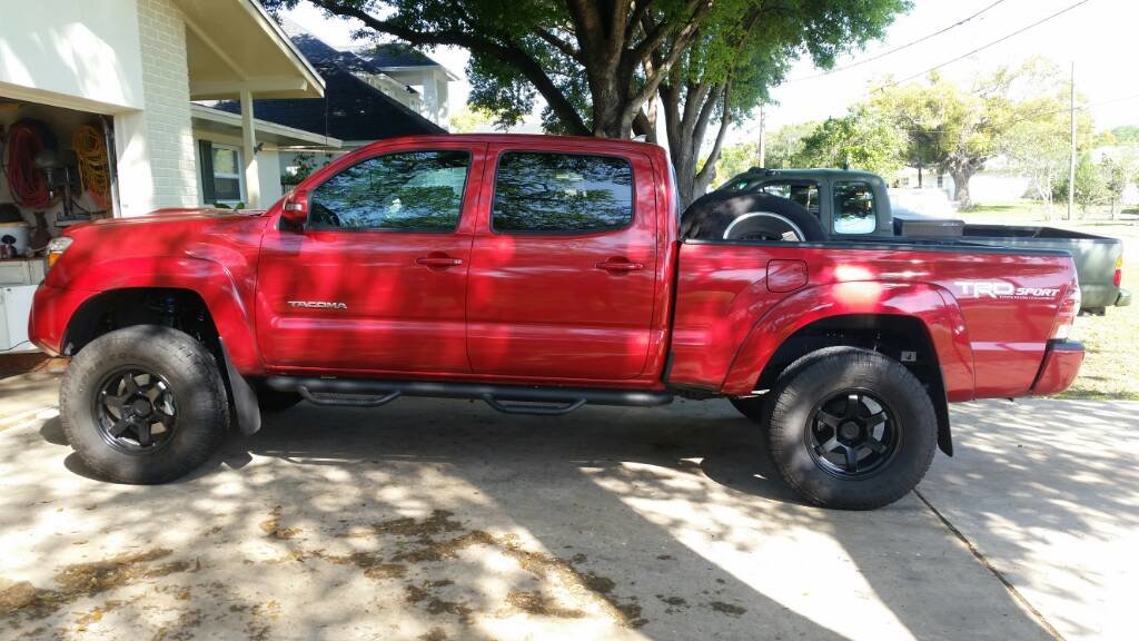

    Hey guys, I have read through almost 70 pages on this thread and my eyes are starting to cross.
    I need a little help with set up. I currently have about a 2 1/4" rake and I want to level the truck with Maxtrac spindles.
    I have been working with headstrong offroad and I am simply planning on doing the spindles with new billies 5100 adjustable set at zero up front (stock coils), and Billy 5125s in the rear with 2" blocks. According to headstrong it will level out, but I want to hear thoughts from the masses who actually have spindles on.
    Also, I am getting new rims with 4.5" BS and I know that will work perfect with the spindles, but my question is with how much spindles kick out the tires even with proper BS? Will I need spacers in the rear to match the kickout in the front? Or will there actually not be any kickout if I have proper BS?
    Thanks in advance for any help/insight.
  8. Apr 8, 2015 at 12:31 PM
    #5828
    SpruceTaco
    SpruceTaco トヨタ
    May 18, 2012
    #79082
    12,271
    Clearwater, FL
    2012 Spruce Mica TRD Sport
    Tinted windows 5%, sill protectors, TRD stubby antenna, weathertech in channel rain guards, wheathertech floor mats, BHLM, Truxedo low pro qt, DTRL deleted, anytime backup camera, bed storage locks, fog lights on anytime, tailgate theft deterrent, painted engine cover, relocated horns, l.e.d bed lights, l.e.d engine bay lights, l.e.d lights above cup holders, in glove box, rear cup holder, in console storage & cubby next to steering wheel, Grillcraft grill, 17x8.5 SCS Ray10's, 35x12.50 Nitto Ridge Grapplers, Borla cat back exhaust, map & dome l.e.d's, TEQ badge on grill, Redline tuning hood struts, Maxtrac spindles, SPC Light Racing UCA's, Bilstein 5100's front set at 0 with OME 885's & extended length Bilstein 5100's in the rear, All Pro expedition leaf springs & 2" blocks, extended brake lines front & rear, 1.5" 4crawler drive shaft spacer, Beefed Taco carrier bearing drop, 1.25" spidertrax wheel spacers on rear, Kenwood DNX570 touchscreen with navigation, 30" led light bar in lower bumper opening, 1/4" top plate spacer drivers side, Bullet Proof Fabricating skid plate, Cali Raised ditch lights & Rago f Fabrication brackets, Amp Research power steps, smoked l.e.d 3rd brake light, Wet Okole seat covers, under cab LED'S tied to dome circuit
    The spindles will kick each side out .75" & 1.25" spacers in the rear seems to even it out nicely.
    Mine with 1.25" spacers in the rear.
    Here's a pic of member Hugopreston's truck with just spindles & 2" block. We did his a couple weeks ago.

    Thanks for the pics to help visualize the lift and the exact info on the tires. Exactly what I needed.
    I think, based on the pic you showed, I may go for spindles with .85 on the front billies and 3" blocks in the rear.
    Do you know the size on your buddies tires (red truck)?

    IIRC his tires are 285/70/17

    Would yall suggest rear spacers to even out the bulge?

    No way those are 285s they look like 265s to me. Could be wrong tho
  16. Apr 8, 2015 at 8:37 PM
    #5836
    nammer
    nammer Well-Known Member
    Aug 1, 2011
    #60945
    9,475
    Nam
    Bradenton, Florida
    Wishing I had a Taco
    yea they're
    "Konig six shooters with 285/70/17 toyo at" -hugopreston

    Well shit, you're right then. My bad.

    haha :thumbsup: it'd prob still look better on 35's

    Yeah like Nam said they are 285's that pic was after we finished the install. I was sure of the 285 but not positive on the 17. The 265's are in the bed.
