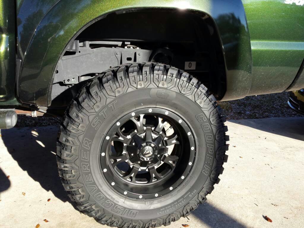

    35/12.50/17 Cooper Discoverer STT.

    How are those STT's?
    Are they loud on the highway?
