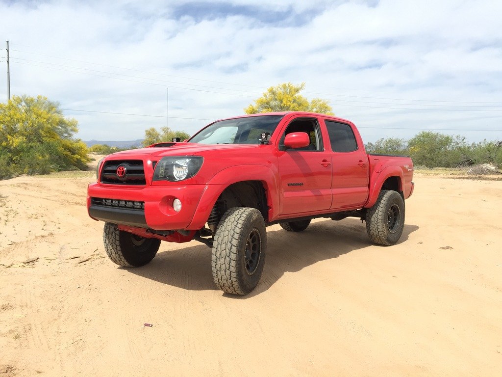

    Anyone running 315/70/17? I have the maxtracs and about another inch of preload after so it sits pretty up there.

    Well I am currently running a 285/75/17 tire. Its about a 34

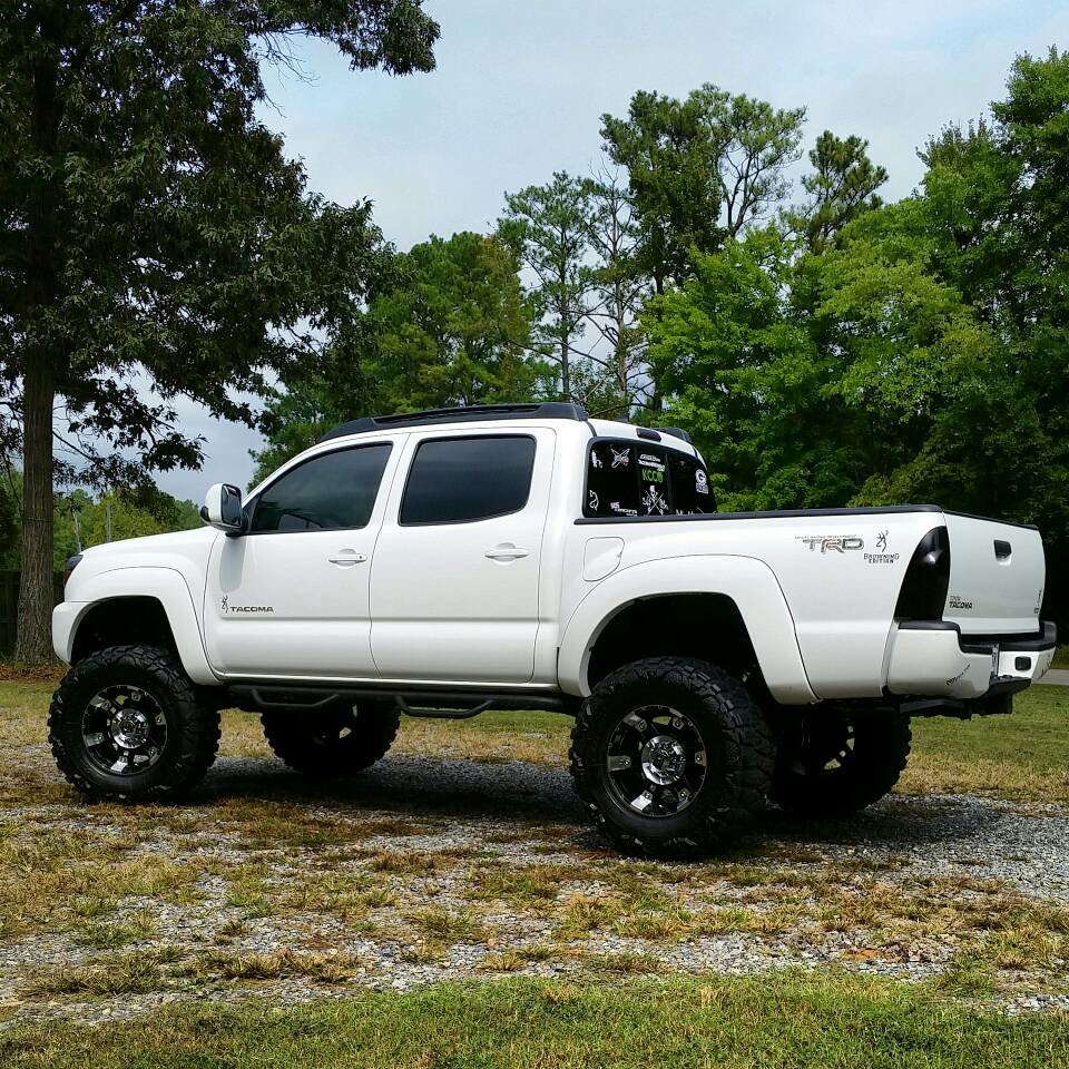

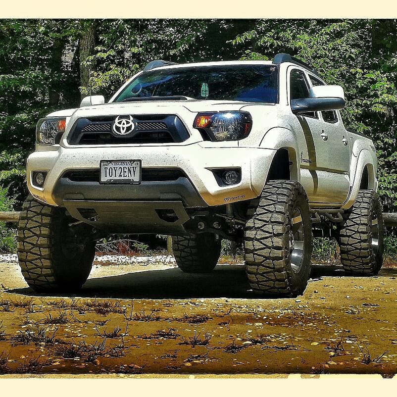

    I find it hard to believe there is a full ome lift on top of the spindles. I mean you are sitting pretty level and I dont think there is a leaf pack that big out there, that would compensate the huge bro lean. Also the control arms dont seem to be angled, also making me assume there is no pre-load. But that truck looks great with the 35's.

    How accomplishing, looks like we both have installed the same shit. So from what I am seeing our angles look about the same and from the looks of it I guess I can go for a 35.

    easily looks like 7'' lift to me

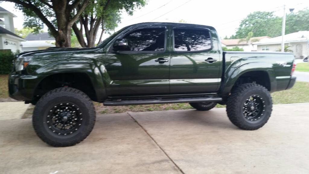

    I guess I'll join in & post a pic of mine with 35's.
    Bandit's lift is definitely possible I have spindles, 5100's set @ 1.75 with 1/4" top plate spacers & the rear is expos with 1.5" blocks. Bandit's is taller than mine, I can tell by the wheel gap.
    Oh & Alcan makes leaf packs that would get rid of huge bro lean.

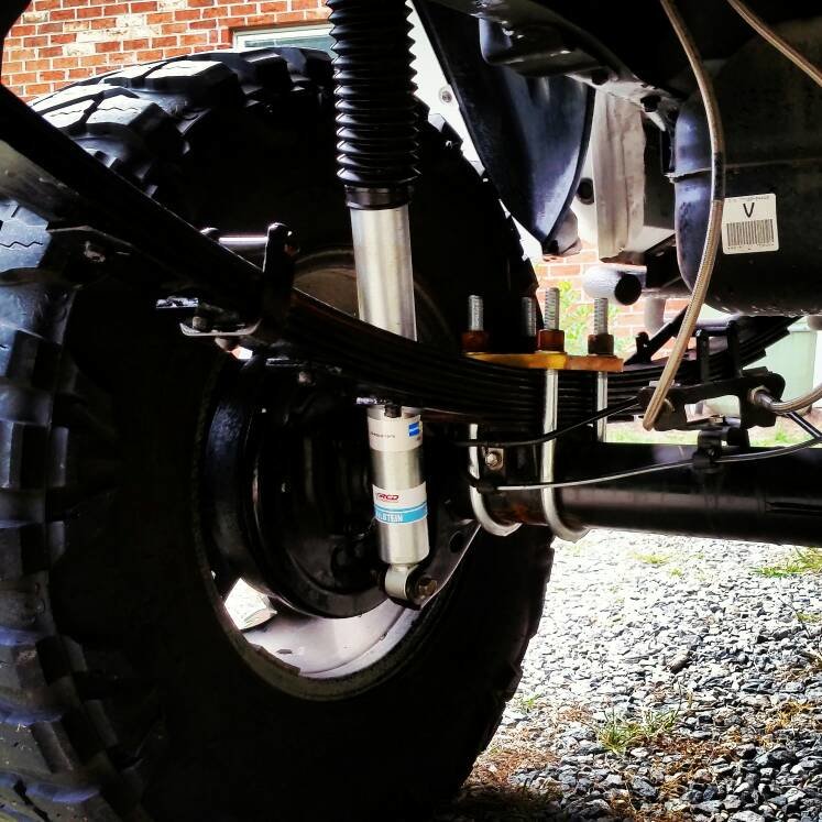

    Spidertraxx 1.25" spacers in front and rear, 4" Maxtrac Spindles,Billy 5100s at 0", OME 885 Springs, 1/4" top spacer on both sides, 1.5" AAL, 3" Block, 1.5" 4crawler driveshaft spacer, 17x9 XD Spys with 35x12.50 Nitto Mud Grapplers, Magnaflow offroad Stainless Exhaust, Volant Intake with scoop,Camo emblems, BHLM, Tinted tailights, Anytime fog mod,Alpine Type R 12, Kicker 1000 watt amp,600 watt 4 channel memphis and all memphis components, 35%tint front all the rest at 5%, Hella 500s with sylvania zxe bulbs, sylvania zxe headlights, sylvania zxe fogs, Weathertech digi fits, flyzeye blue/white, LED map dome license plate lights, Redline hood struts, Tailgate EZ Down, Custom TRD Camo Browning Edition Bedsides, Camo wet okoles, Ridgid Dually bed lights, SOS Concepts Tire Carrier
    All this is true lol.... I gained 4" from my bilstein, 885 setup plus the spindles was sitting at 8" front and then had the 6" Alcan pack in the rear...35s fit with no problem..no rub..and i was running 1.25 spacers 6fa73ca355d51419db356c31c8b21f6d_7069ed4ba1a49d6e3aa107c1e7cfd682fd87fe8d.jpg587d2fad23d88dc23b61f8e60d1040fc_c4d60070b5875ae45f6ce0e08dd96faaf4081c6b.jpgdf677c5ffbab7ed2e34f5b315da1422d_1d5be9832d5ec848dfafadc5e395b57917f56d34.jpg
