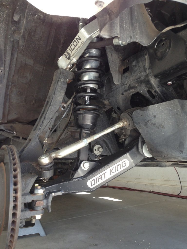

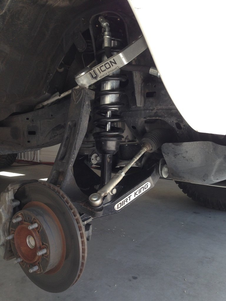

    59926P ICON 2.5 Remote Reservoir Front Coil Over Shocks 56103 Icon Rear Hydraulic Bump Stop Kit K53163 Icon RXT Leaf Springs Kit 58730 Icon 2.5 Front Remote Reservoir Coil overs 59926P Icon 2.5 RXT OMEGA Remote Reservoir By-Pass Shocks 58550 Icon Billet Aluminum Upper Control Arms Dirt King Steel Lower Control, 1” Uni-ball Joints Archive Garage Rear Leaf Spring Shackle Flip Kit TRD Cat Back Exhaust TRD High Flow Air Filter Kenwood Receiver + JL Audio Speakers Extended Stainless Steel Front Brake Lines Extended Stainless Steel Rear Brake Lines Electronic Locking Rear Differential Rigid LED Driving Lights LED Bar in Bumper Top Windshield LED Bar Custom TACOMA Raptor Grill w/ LED Running Lights METHOD Standard Matte Black Wheels
    You bishes think I need limit straps ? ? ?
    I mean it's barely just resting completely on the coil over, hose at full droop with no weight from the tire ! ! ! Seriously what could go wrong ? ?

    I'd honestly would have to say if the uca is touching the coil at all then yes, you'd need limit straps. Don't want that UCA to keep hitting the coil at full droop now

    extended or stock length LCA? looks like good travel from that setup

    Obviously stock, the UCAs are Icon and Icon doesn't make extended UCAs the last I checked :eek:

    Yes! install limit straps before you damage the lower misalignments on the UCAs, looks like they are maxed out. Or you could change out the rod end on the Coilovers for a shorter one, are they the limiting factor for droop?
    Stock Length LCA -
    Icon EXT Travel 2.5 Remote Resi -
    Icon Billet UCA -
    MaxTrac Spindle -
    Sway Bar Freshly Removed.
    In the shot the UCA is Completely resting against Coil Spring + Remote Resi hose at full droop !
    The post was to illustrate what kind of travel to expect with this set up.
    Any recommendations on brand/type of strap? I'm thinking adjustable clevis type design . . .
