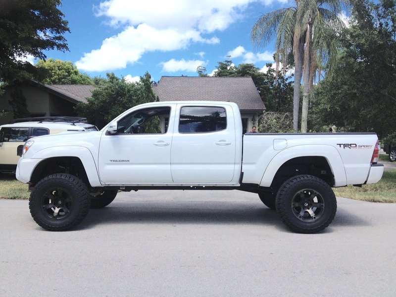

    Some friends and I installed my spindles today, went with 5100 set at 1.75 + a 1/4" spacer up front with stock spring and a 3 leaf AAL and 3" block in the back. Ended up over 6" of lift. The tires are Cooper st maxx 295/70/17.

    Looks great Mike!
