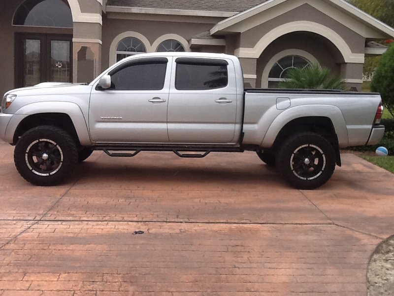

    I have 285/65/18 trail grapples I had to trim quite a bit because they rubbed. Just have to trim the plastic, the tires didn't hit the cab mount or anything.
    It did rub more on the drivers side so I would suggest getting a 1/4" spacer to install while you have everything apart. now I have bilsteins set at 1.75 so I don't have to worry about that anymore.
    Here is a old pic with just maxtracs and the standard all pro leaf in back

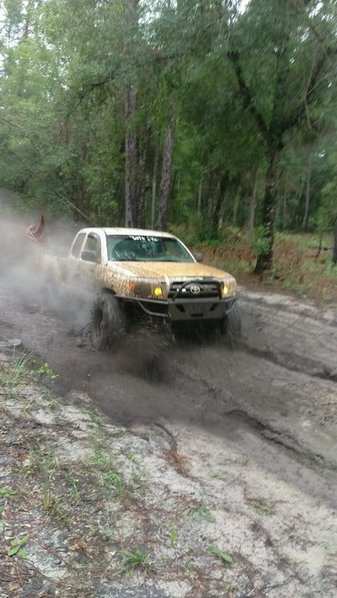

    My favorite picture yet. :facepalm:I tried backing down a hill to put my kayaks in the water and going back up was only possible with the help of the Diamondhead fire department and a Warn winch :anonymous:. Props to being a firefighters son.

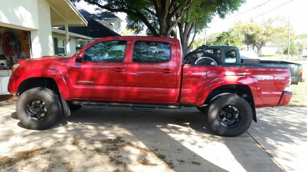

    this one has 4"maxtrac spindles with a 3" spacer up front and rear has a 2" aal with 4" blocks running 285/70/17 getting ready to put on 35s soon i hope
