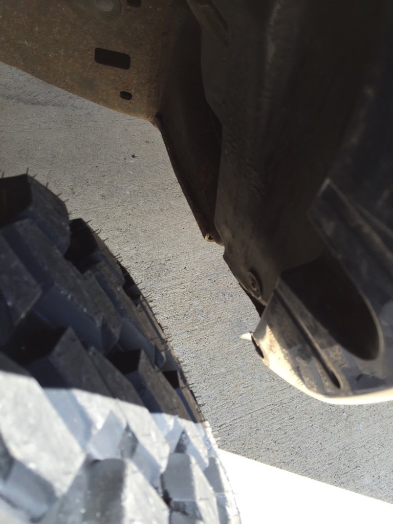

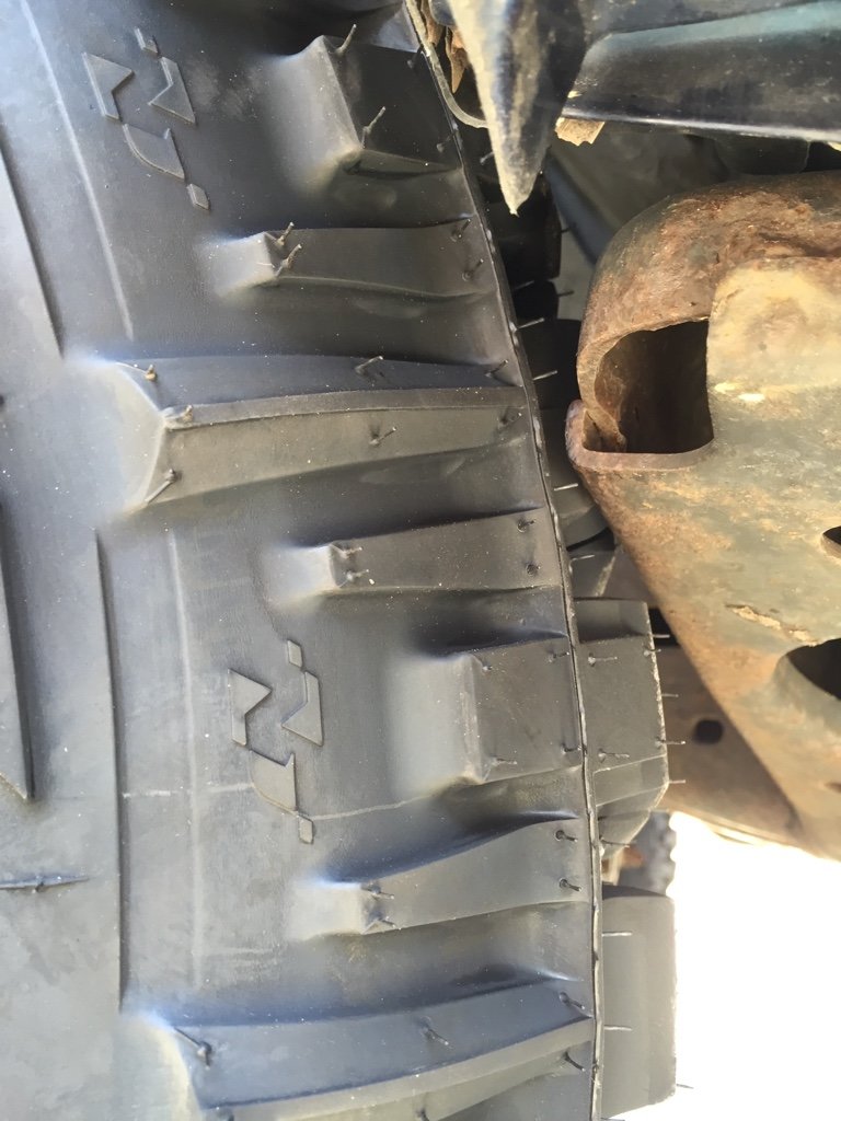

    Hey guys, just installed my spindles and put on some 285/70r17s trail grapplers. Got a little issue with rubbing on the cab mount. Got a master welder who said he can modify the cab mount for me, but I am hesitant to do that. Won't be off roading so that's not too much of an issue for me. I'm looking for advise on whether a spacer would fix my issue or not. ad47a1b3333a7ca0514e1dba79c43d8c_8d4900707235ce01a2cd128bb22182d476d2215f.jpgb053833f263c84f7ef77f298a5cbb23a_409a4ba4cf26d4c2f2862a39d7c514745e3523f1.jpgf8d27f2d0563cc168012399e15d7eb69_4f75bd1c541e3a08c7429ea9f228e98b6065fbfd.jpg
    The bottom pic is full turn. Any suggestions?

    Chop your cab mount. Shouldnt cost more than $150 and they carve it back almost right to the bushing

    Looks like it's rubbing on the fender flare also, looks like it rubbed a hole in it. Trim the corners off those also.

    Yeah that was the first pass at trimming. I cleared all the plastic now, just hitting that cab mount. I'll get it chopped just to make sure I don't have any issues with it. Haven't even taken her on the road with the new spindles yet. Don't want to tear my flares or bumper off if I hit a bump or something. Haha

    I trimmed the whole inside corner off mine, don't have any pics though.
    I think wheel spacers will make it worse cause they will push the wheels out more. If my thinking is right you'd rub sooner, like not getting to full lock before they rub.
