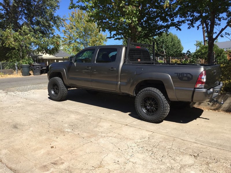

    I have 5100s up front set at zero and the rear is the ome Dakar leaf pack with sport ome shocks. i need to measure it all out to see what my official gains are. I'll update after I get home with that

    I had a little vibe only once when taking off at a steep incline. The kit came with the carrier bearing drop kit and I did put it on.
