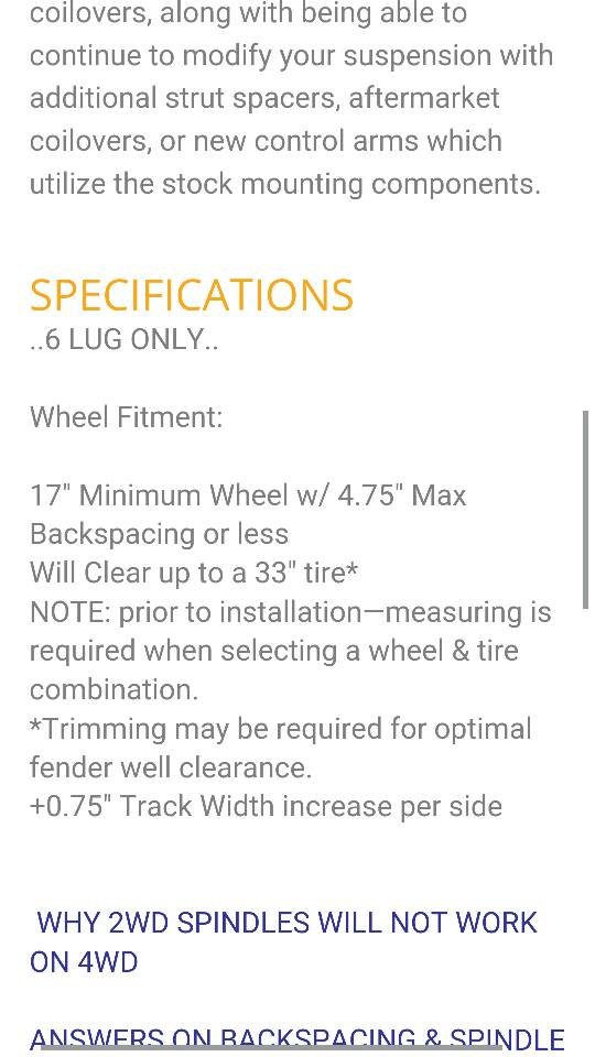

    So if I'm reading correctly I still need spacers for the sport 17s. They need to be a 1/4in about to trade my 20s tomorrow and don't want to have to sit without wheels until spacers come in

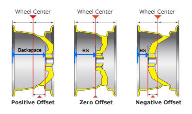

    I THINK the 17s should fit...im not too sure though. I know with my 16s having 4.5 BS they still clear the spindles. They might not with having 5.5? i think it is, only way to see is to try em on

    ya thats what I was thinking, I didnt know the backspacing on the factory sport wheels. Since i have 16s, I wasnt sure if any 17 would be able to fit as they are 1" bigger than my wheels are

    Aluf has a point, my back spacing is bigger than what mantrac recommends but I'm on dubs so that gave me room
