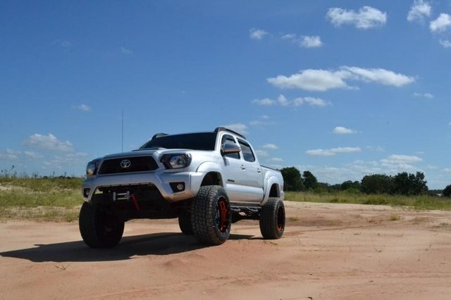

    Them are red I have a silver truck with orange accents. 305/55/20$ to 35x12.50x17

    Springs were bought

    The toytec's are red? Mine are silver.

    Dang. Those should look cool. Are those for the 5100's or the 6112's?

    I didn't find any other springs on the site so I guess they are for either I sent him a pm asking.if they would work on 5100s but the way the talk was on that thread it was the same springs just red

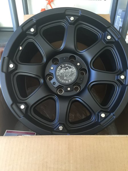

    Max Trac spindles, 2" blocks Max Trac shocks on rear. Color matched grill surround with T-Rex black billet insert and color matched rear bumper. 5100's @ .85 Black Rhino "Glamis" 17x9 -12 offset Cooper Discoverer MTP 285-70-17
    Just pick these up 17 x 9, 4.50BS. If I run 285/70's will I have any rubbing issues. I'm gonna go with all terrains. everything will remain stock up front except the spindles.

    Remove the mud flaps (including front) and should be fine. Depending on tire selection you may need to trim just a tiny bit to prevent rubbing when at full lock in reverse but not much at all. Good luck :thumbsup:

    You sure about that? -12 offset with a 285/70 seems like its going to be scrubbing away at that cab mount. Especially with the added .75" with the spindle. o_O

    So would 265 be the way to go since I don't want to chop.

    265 would look like your truck skipped leg day. Run 285's and you may have the slightest bit of rub, but because your suspension geometry will stay the same as factory, you should be able to get 2-3* caster which is more than enough to keep your tires off the cab mount

    Im sure. I personally run wheels with a -12mm offset with no issue of hitting the cab mount. I had the same concerns when I first decided on my setup and its not even close.
