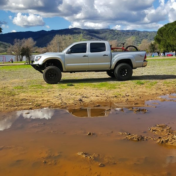

    image.jpg Mucho happy with mine, billies set at .85!
    ChadsPride likes this.
