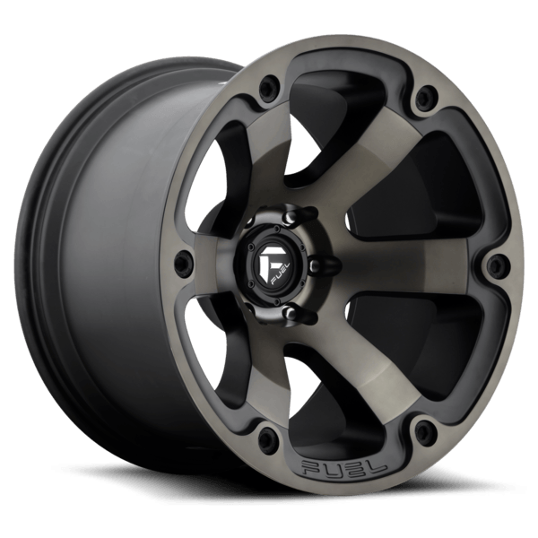

    Greetings. Newbie here with 2013 PreRunner Double cab SB. Thinking about this setup and would appreciate some feedback.
    I’m going to try to order as many of the parts as possible and save a little $ but will definitely be taking it to a shop for installation. Let me know if there are any group buys in the works…
    Any other suggestions/recommendations appreciated. :help: :thumbsup:
    · Maxtrac 4” Lift Spindles
    · Bilstein 5100 Adjustable Front shocks
    · Toytec Front Top Spacer
    · Bilstein 5100 Extended Length Rear shock
    · All Pro 3” Leaf Pack “Standard”
    · Spidertrax 1.25” Wheel Spacers for back
    · Toyo Open Country ATII LT285/70/R17
    · Fuel Beast 17” rims
    1. Based on this setup, anybody see any problems or issues?
    2. Can I get away with using the stock springs up front?
    3. Can I use the 285 Toyos with these rims and be good with fit? I know the tires will stick out some up front with the spindles but would like a bold stance and no rubbing. The BS needs to be less than 4.5? Does that mean the rim should be the -12?
    4. Any estimate on what the labor $ would run out the door?

    1. You will probably have to take your front mud flaps off. Might as well look into getting longer brake lines for the rear. Also you will end up needing to get a driveshaft spacer and cb drop bracket. Once you get your lift installed you can figure out what size ds spacer you will need.
    2. Yes you can use your stock springs.
    3. The wheels you are looking at are 17 x 9 and will work fine with the 285's. Make sure to get the -12 offset ones that way your bs will be 4.5.
    4. To be honest on labor im sure a shop will hit you up pretty good. If handy or if you know someone locally that can assist you that could save you a lil.

    Thanks for the reply. Unfortunately, removing the mud flaps might be the only thing I can handle. :anonymous: So, the tires/rims should be good and no rubbing? I'll double check with the shop but looks like I'll start ordering things when I can. Now to sell some OEM chrome running boards and a A.R.E. LSII Tonneau cover. Have to liquidate some assets and look for a second job. :thumbsup:

    Those are nice looking, which model is that? I have Fuel's myself, they're not as common as some others.

    Fuel Beast D564 I believe. From what I've read, they're a little heavy but I haven't see any of them around here. Kinda like badass green trucks like yours :thumbsup: and that's one of the reasons I'm considering them. Was told they might also take a while to get...

    D56417908345 Beast 17x9 6x5.5 -12mm
    https://www.treaddepot.com/#!shoppingCart in stock 963 otd w free shipping
