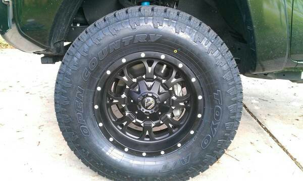

    Don't think you can go wrong with in stock & free shipping. Haha
    Just to give you an idea, same wheel specs with the same tire & size you want. I got the p rated version but would suggest the xtreme version, they look beefier. I have since switch to 35x12.5

    I have bought from both places with no issues at all. If you want to go with the extremes here are the only sizes they come in.
    Extreme Sizes are: LT295/75R16, LT305/70R16, LT315/75R16, LT285/75R17, LT35X12.50R17, LT285/65R18, LT285/75R18, LT325/60R18, 35X12.50R18, LT285/55R20, LT305/55R20, 35X12.50R20 and LT325/50R22.

    Not opposed to a little more beef. In looking at the TW comparison, the extreme tires do look better. I had read in a number of posts that the Toyo AT IIs were pretty good quality. Is the LT285/75R17 and LT35/12.50R17 basically the same size-wise? What would the Beast rim specs be for either of those and would there be rubbing issues? Just when I think I have things figured out... But I don't want to have any regrets and do appreciate the advice. :bowdown:

    Those 2 sizes are not the same, the 295 is only 11.2 wide & like 33.8 tall. Wheel specs are gonna stay the same no matter what tire you pick, 17x9 -12 offset 4.5 backspace. Wheel specs will only change if you pick a different size wheel.
