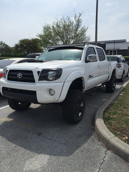

    4" Maxtrac spindle lift, adjustable bilsteins up front set at 1.75", 2" blocks and pro comp aals in the rear. 33" Cooper STT Pros.
    Gonna get some better pics soon but here's mine with the spindle lift, adjustable bilsteins at 1.75 in the front, and 2" blocks in the rear. Buying aal's monday to level the truck betterimage.jpg image.jpg

    Looking good!

    Nice!! What size and brand of tire are you going with. Also with the 5100 at 1.75 how bad is the lean? TIA.

    As far as tires go im not too sure yet. But im thinking of going with bfg ko2's just not sure what size ill be able to fit. Unless my friend at 4wp steers me to something else. The lean on the other hand, well, it's definitely noticeable lol. I can feel myself sitting back into my seat because of it but Im buying add-a-leafs tomorrow to level it out. Once i get those installed ill have a better idea on tire size i can go with

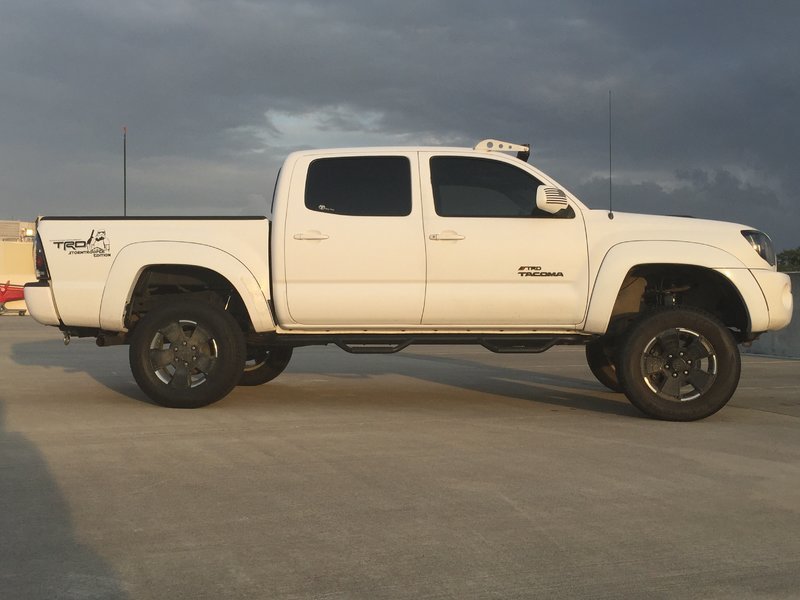

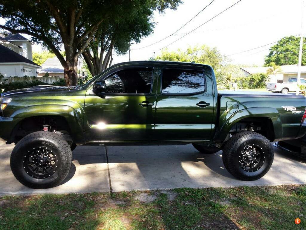

    My truck with the same set up as @Rwood90 with 17x9 -12 offset & 285's.

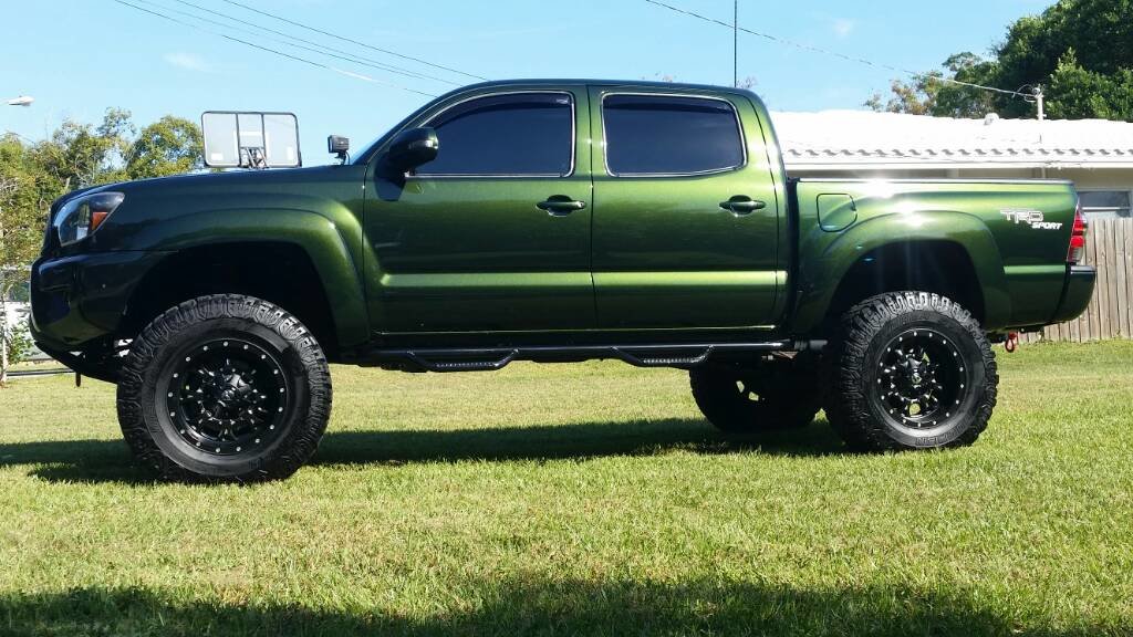

    Same set up but with the addition of Toytec's 1/4" spacers on each side for another 1/2" of lift & 35's.

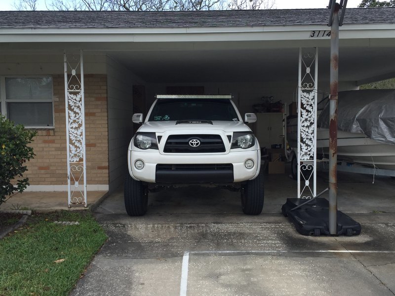

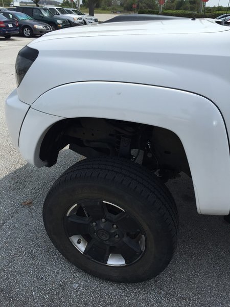

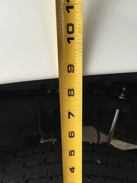

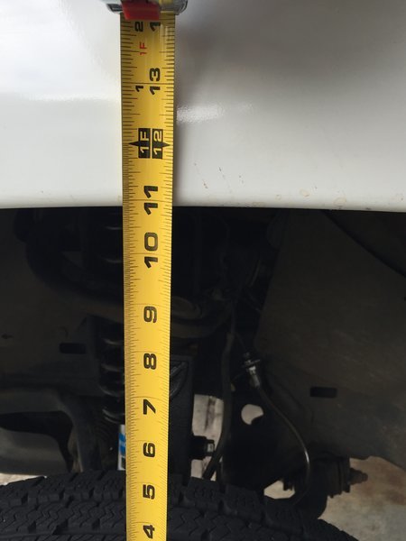

    @bbell7d6
    And another front shot just because. Will get some side shots a little bit later today image.jpg

    So you stacked the spacers? Also how much cutting did you have to do to fit the 35's?

    No I didn't stack spacers, I have one 1/4" spacer on each side. The 1/4" spacer provides about 1/2" of lift. Only trimmed the wheel well liners & the lower corners of the fender flares behind the tires. Probably gonna do the cmc eventually.

    1/4" spacer = 1/2" lift due to geometry.
