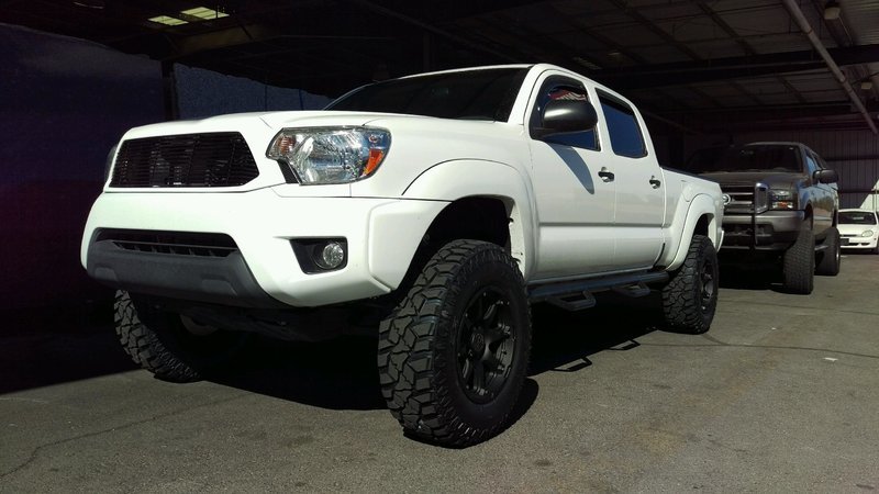

    15 PreRunner SR5
    Max Trac spindles, 2" blocks Max Trac shocks on rear. Color matched grill surround with T-Rex black billet insert and color matched rear bumper. 5100's @ .85 Black Rhino "Glamis" 17x9 -12 offset Cooper Discoverer MTP 285-70-17
    FINALLY!!!!!! Got the wheels and tires on! Thanks for all the help peeps!

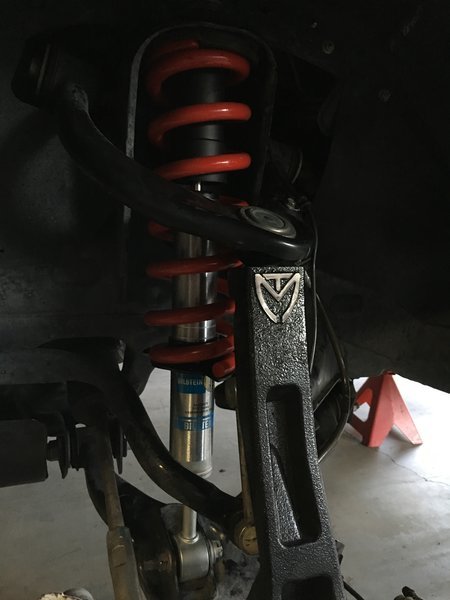

    15 PreRunner SR5
    5100's installed!! Set @ .85 along with Max Trac spindles. Also the UCA'a aren't angled as bad as it looks. They're only a little off from stock.

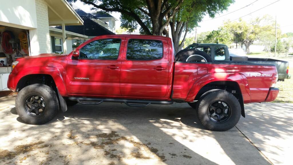

    can someone post pics of their setup with just 4" spindles and 2" block?
    Looked through atleast 100 pages already.
    Trying to decide on going with the maxtrac 4"/2" lift or going with a smaller lift (5100's, eibach 1.6", 1"block)
    Thanks

    Not mine, it's @Hugopreston 's old truck right after we installed the Maxtrac 4/2 kit.

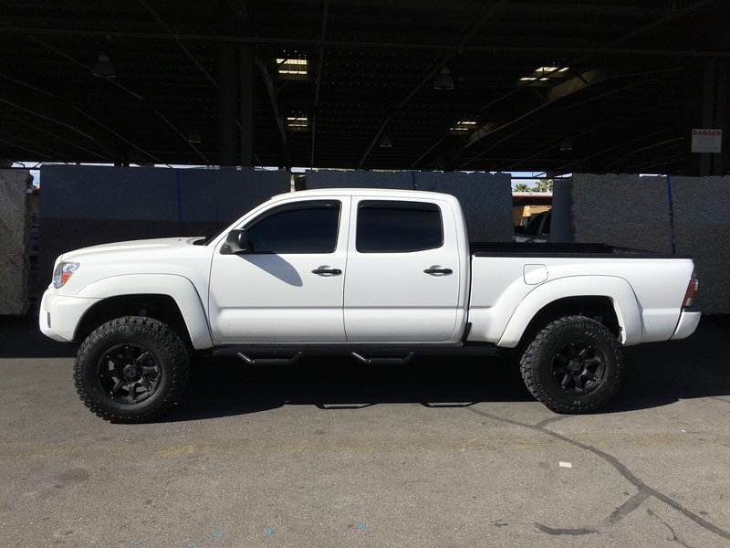

    15 PreRunner SR5
    @bevans Heres mine with a 4/2. Running 285-70-17 Cooper Discoverer MTP & 17x9 -12 wheels

    Thanks, bbell7d6 and SpruceTaco those trucks look great! My truck looks about level with stock suspension... not sure if I should jump up to a 3" block to avoid being nose high.. Not really wanting to mess with AAL's.
    How does it ride? Does it wander any at 70-80mph?

    @bevans it wanders a little but only from my new tire set up. I had my stock wheel and tires on for a few months and it handle same as stock.
