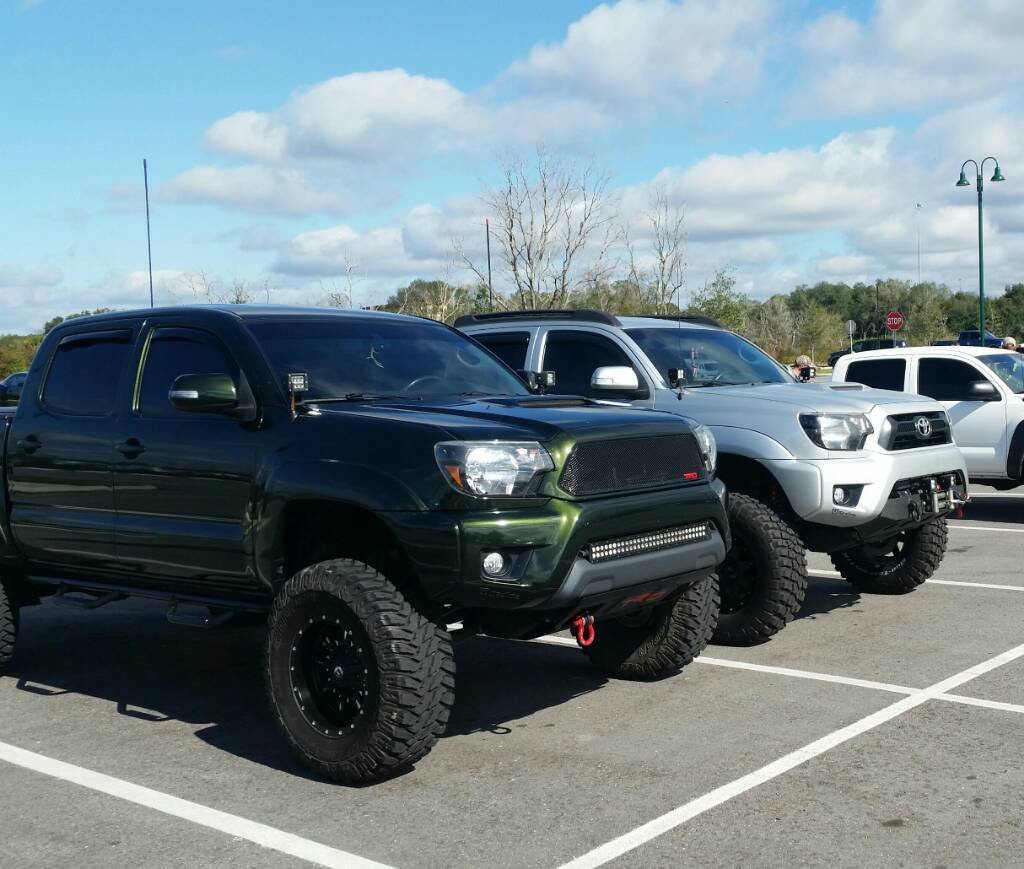

    :humble: hahah. If you put mine and @SpruceTaco next to each other our setups are very close

    Yeah, yalls have some tricked out Tacos.
    Very nice, berry berry nice.

    Between you two I wouldn't know which one to choose if you were saying "I'll give you my truck for free but you have to choose one" they are so nice!

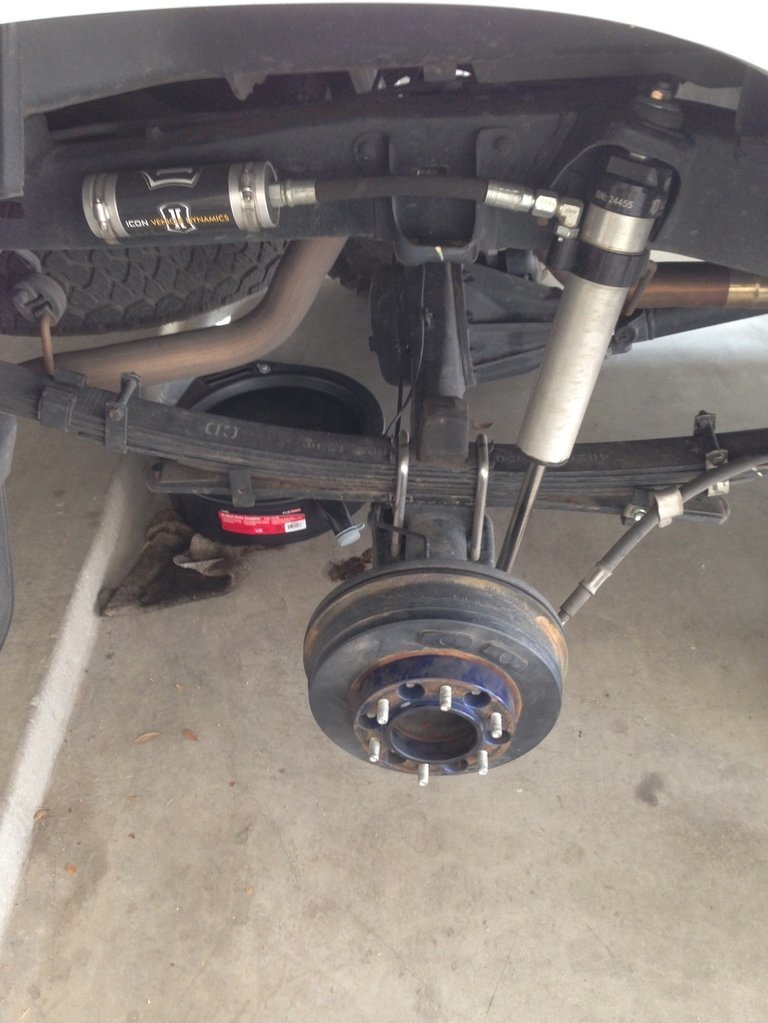

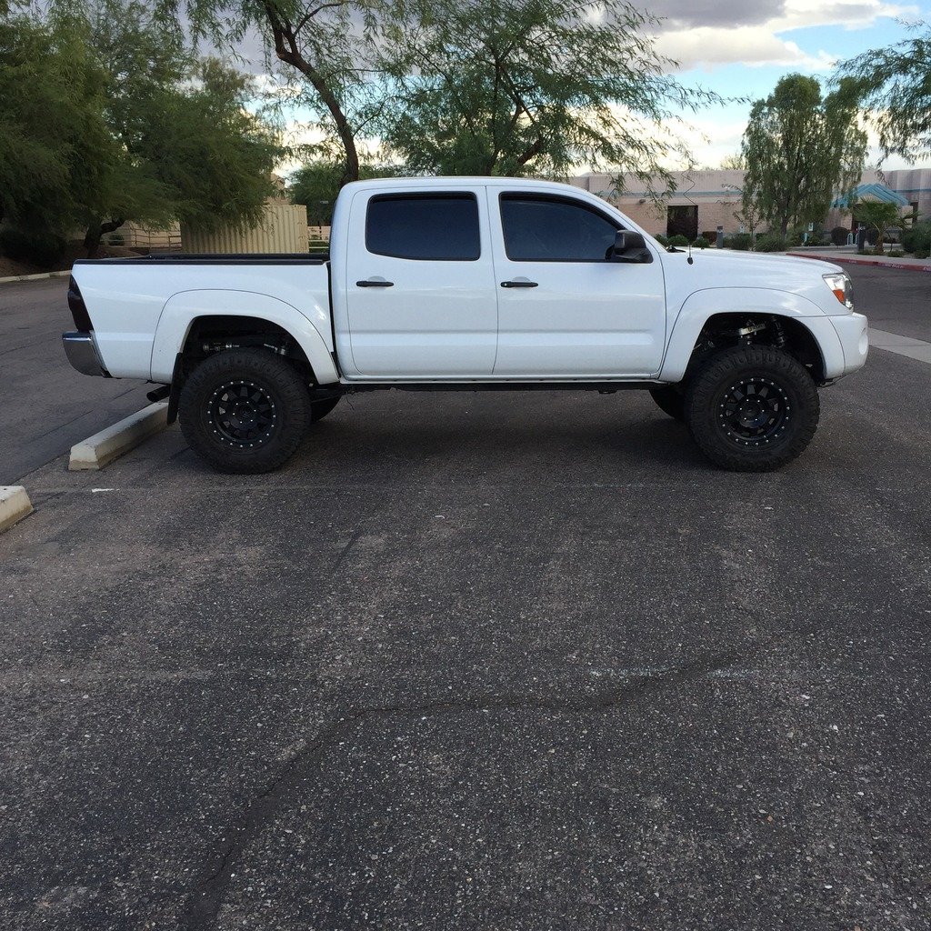

    I'm running 16" Method Standards on 285/75R16 Goodyear Duratracs with Zero Issues . . .

    My Bad Kevin, I meant to attach the shot where I'm showing there's no spacers, I'm only running the 1.25" Spideys on the rear and Not the front . . .

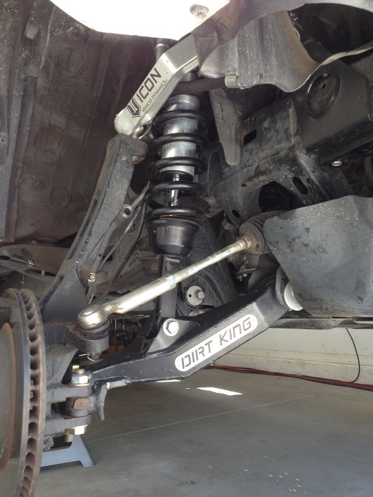

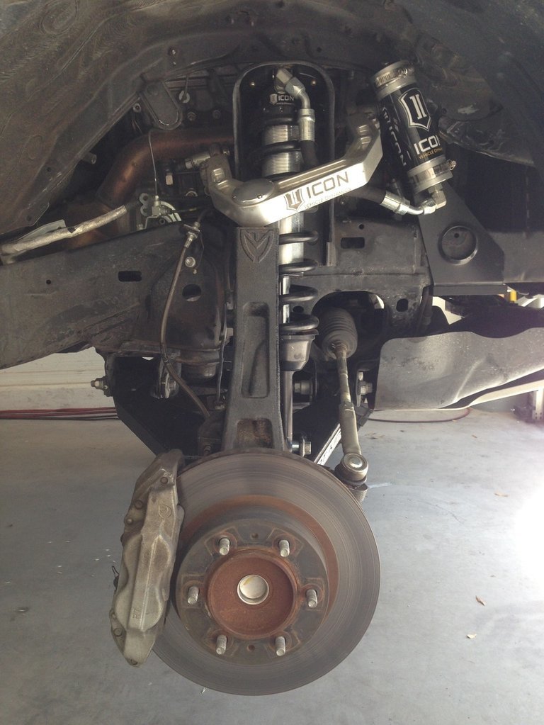

    No Sir, Only if you're using the MT Spindles to get your lift, the beauty of the MT Design is you retain your factory geometry negating added expense of after market UCAs.
    If you look closely at the 1st pic you'll see my UCAs are still very much, Completely Flat.
