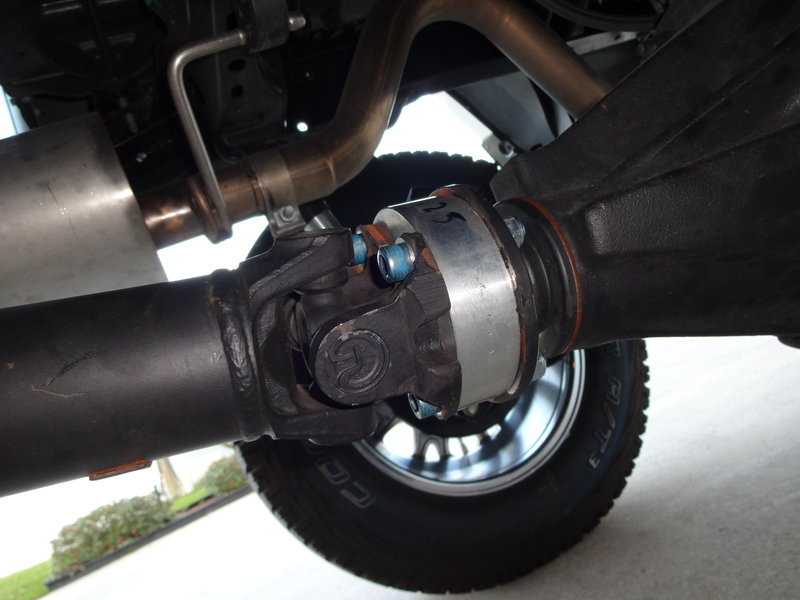

    You need a driveshaft spacer to push it back where it was at stock .

    For those of you that have purchased the All Pro Expo leafs, where did you purchase in the end? Straight from all pro or from another merchant?
    And where did you find the drive line spacers as well? I assume the size of the spacer varies from truck to truck.

    My expos came straight from All Pro, when you say driveline spacer I assume you mean driveshaft spacer. That came from 4-crawler offroad.
    http://www.4crawler.com/4x4/ForSale/DriveshaftSpacer.shtml
