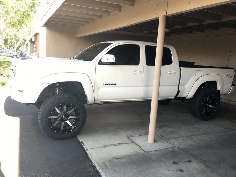

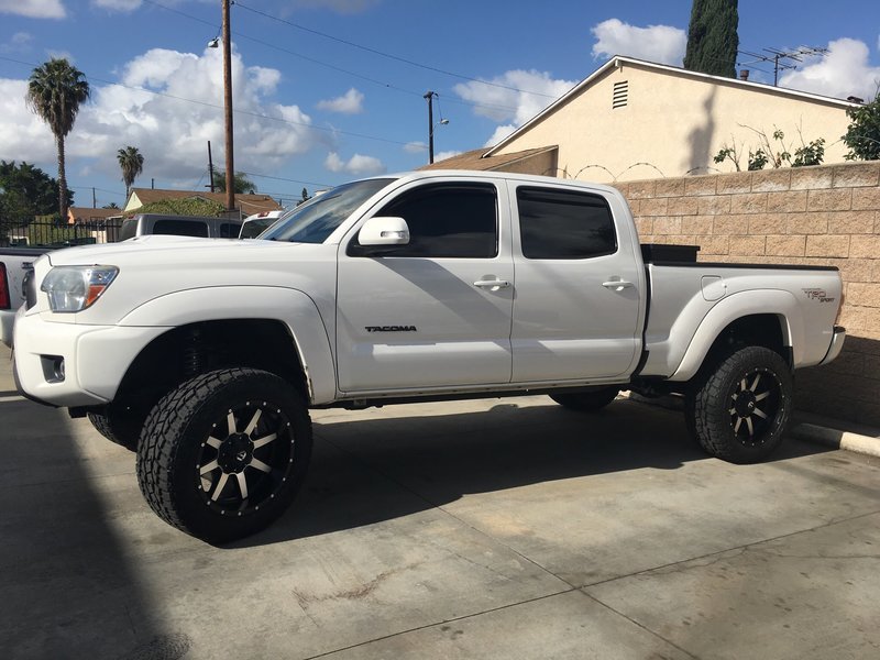

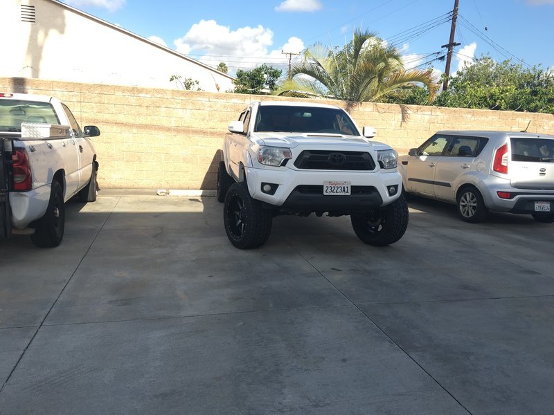

    Finally got them all done.
    Mactrac spindle
    Fox 2.0 coilover
    All pro expo
    Fuel offroad 20"
    Toyo 285/55/20
    Want n-fab nerf bar next!
    Also there some rubbing on the fender
    Do u have any suggestions?

    CUT CUT CUT as much as you can
    Looks good though :D

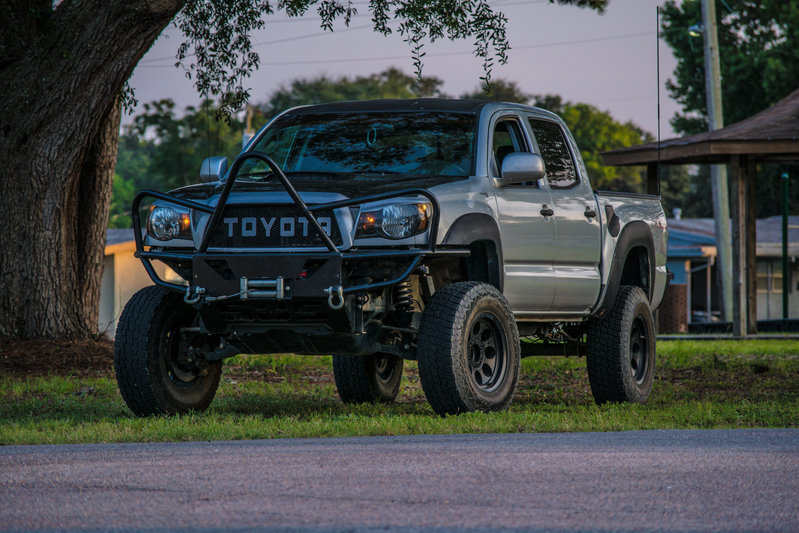

    figured id throw an update photo in here :D

    Looks good Chris! Any plans for paint? I know you got the '80 going on.

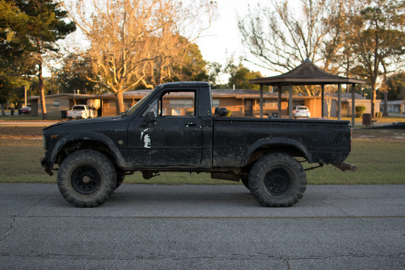

    thanks man! not anytime soon lol, id like to wrap the truck....but not really wanting to spend the money on that. so the fenders are staying black until I can figure it out haha
    yeah I saw the notifications haha, it has come a long way in the last 2 1/2ish years. well you can get them, just only run those and dont get a bumper haha

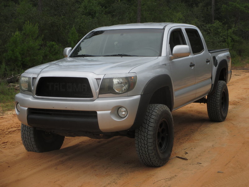

    I mean you could also upgrade the coilovers too, like get some Bilstein 5100s but put them on the 0 setting so you get no lift, just ride quality upgrade, but pretty much thats it. with the spindles, you dont need upgraded UCAs since it doesnt mess with the geometry like bigger coilovers do
    But it just makes the truck look a little ridiculous lol here's a couple photos after and before the bumper lol. the 2nd photo is the exact same suspension setup as the first photo. midtravel and the maxtracs on, just the only difference is the bumper lol
