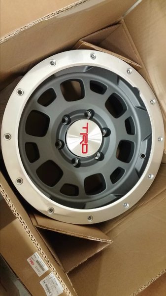

    Hello TW folks,
    I asked a question on here before and I forgot what the answer was. I know someone answered it but dammit, I forgot. I apologize to whoever answered it for me.
    Either in October (my wedding anniversary) or for Christmas I will be getting a set of these:
    Here's my concern:
    Will these work well with my Maxtrac Spindles WITHOUT front wheel spacers?
    I'm running 17" OEM FJ 6-spoke wheels now and I have Spidertrax on the rear ONLY so that the rear wheels stick out enough to match the front. They clear the front spindles just fine. I don't want to add spcers to the front because then the fronts will stick out more than the rear.
    Anyone run these 16" OEM TRD sumulated beadlock wheels WITHOUT front spacers?
    I'll be sure to write down the answe this time. :rolleyes:
    Thank you.

    Maxtrac says minimum 17" with a max backspace of 4.75", that being said people have run 16" @Alfuh is the first one that comes to mind but he's running aftermarket & I'm not positive what his backspace is.

    YES! They will fit. I had them on for a day when I first lifted my truck and before I put on my wheels

    Yeah my 16s have 4.5" backspacing which is why I'm able to run em

    I'm going to be running these 16" rims with the 4" spindles, but I'll be at 4.00 backspacing to offset the decrease in rim size.
