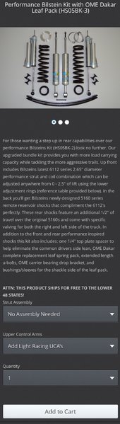

    Finally upgrading my stock springs and shocks. Should pair nicely with my Maxtrac spindles.
