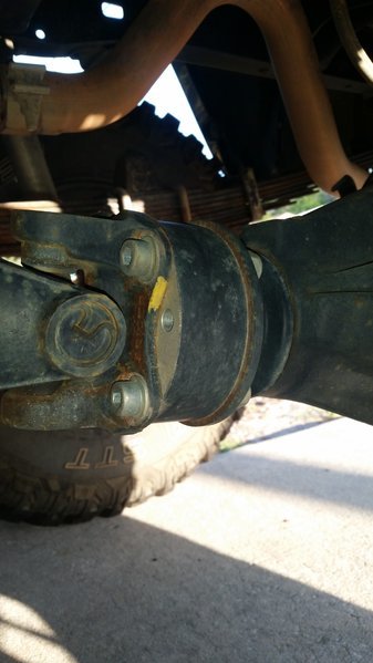

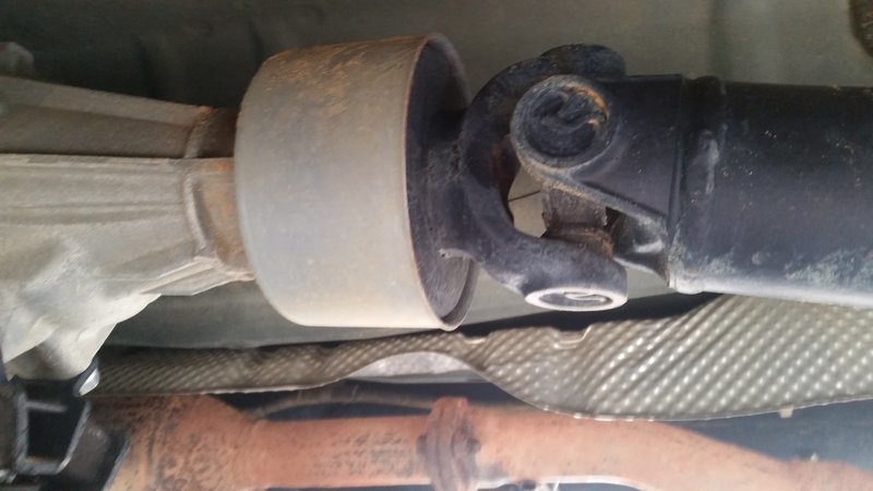

    This is what it looks like from the factory.
    This is how mine looked after the rear was lifted. The spacer just puts it back where it belongs & as @sgtnewundies said the spacer size will depend on lift. Also up travel can be shortened by installing longer bump stops.

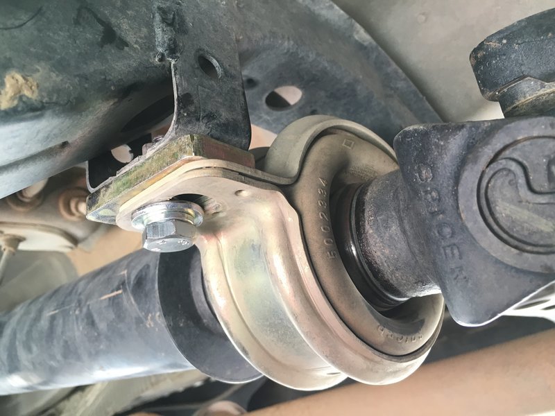

    Has anyone tried these OME Driveshaft spacers?
    ChadsPride likes this.

    That pic isnt the spacer but I got the 1.5" spacer.
    This is the spacer, it goes in between the flanges of the driveshaft & rear end.

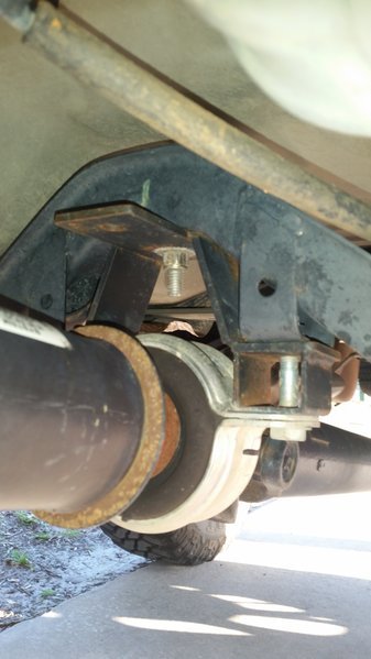

    I have the Beefed Taco carrier bearing drop but my rear is lifted 5.5"

    That is the CB drop kit, I have that and a 1.25" driveshaft spacer and have had no vibration issues
    SpruceTaco and ChadsPride like this.

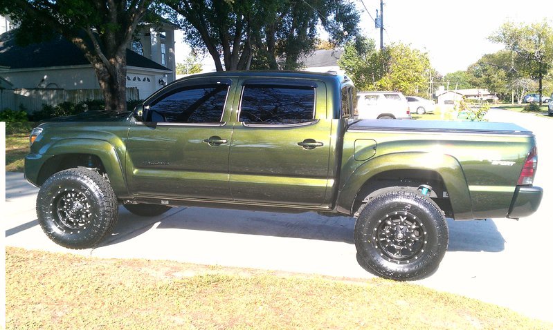

    It should, the 4" Maxtrac kit come with 2" blocks & longer shocks for the rear.
    This is @Hugopreston 's old truck that we installed the 4" kit on. Only spindles up front with factory shocks & 2" blocks with new shocks in the rear. 285's if you're wondering.

    Hugopreston
    Hugopreston Well-Known Member
    Feb 23, 2015
    #149427
    1,171
    Hugo
    Tampa, Florida
    20 TRDOR MT DCSB
    The red truck you quoted was mine. I did not sit 100% level. Sat a little lower in the rear. Not much. Like a .5 inch
