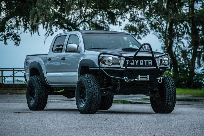

    well with these dirty5s, its kind of needed haha, I think they are 3" flare and 6" rise...I think, dont quote me lol. Here's before I put the fenders on, I could barely daily drive lol any amount of articulation and my tires were eating my fenderes
    ChadsPride and CodyTaco[QUOTED] like this.

    The glass looks just right for not having LT
    Haha that's how the rear of my jeep is right now. I keep trimming half inches at a time but seems like every time I go out.. bam! Tire/fender sex.
